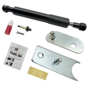

This is the installation process for the TA-C-0006: 2007-2018 Chevy Silverado GMC Sierra 1500 2500 3500 Tailgate Assist Shock Kit,provided for your reference during installation.

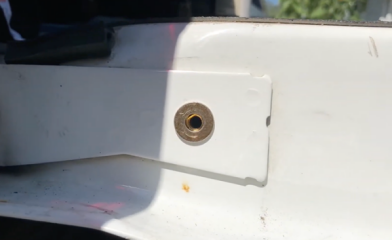

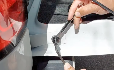

Using an M5 Allen wrench and a 10mm wrench, install the blind nut into the opening near the rear bumper pivot point. Tighten the nut at least 9 turns. Mark one side of the nut and count the turns to ensure accuracy. After tightening 9 turns, if the blind nut can still move or rotate, continue tightening for 1-2 turns. Recheck the blind nut and repeat the above steps if necessary. Note that overtightening the nut can damage the threads, rendering it unusable. After installation, remove the blind nut installation tools.

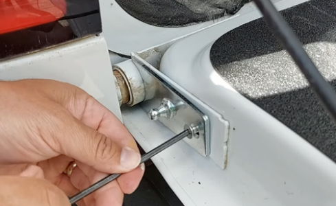

Install the bottom ball head mounting plate by inserting the bolt through the hole in the plate into the blind nut. Tighten using an M4 Allen wrench. The torque is 8 ft-lbs.

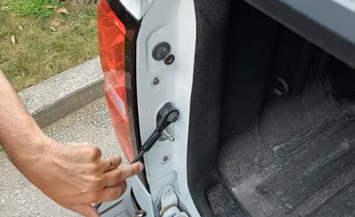

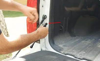

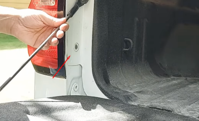

Remove the rear bumper cable and use a 13mm wrench/socket to remove the cable bolt. Using the bolt removed in the previous step, install the top ball head mounting plate with a 13mm wrench/socket. When tightening, hold the mounting plate vertically; otherwise, it will rotate. Reattach the cable to the cable bolt.

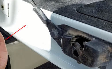

We provide polyester film to prevent parts from sliding on the truck bed and tailgate. Apply the polyester film to the truck bed and tailgate, especially where the tailgate auxiliary parts will be close during opening/closing. The arrows in the diagram indicate the installation positions for the polyester film. The vehicle shown in the diagram is only an example of polyester film installation. Your vehicle may differ from the one shown in the diagram.

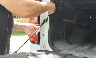

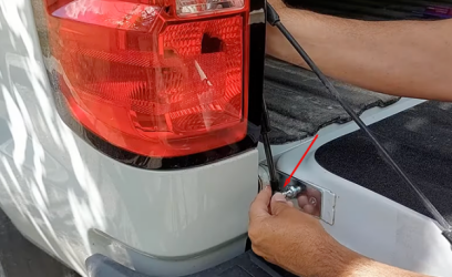

Install the thicker end of the shock absorber onto the upper ball joint mount. Install the thinner end of the shock absorber onto the tailgate ball joint mount.
