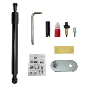

This is the installation process for the TA-D-0009: 2009-2018 Dodge Ram 1500 2500 3500 Tailgate Assist Shock Kit,provided for your reference during installation.

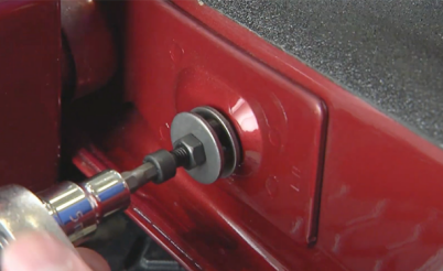

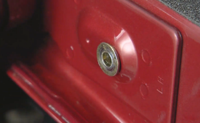

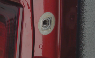

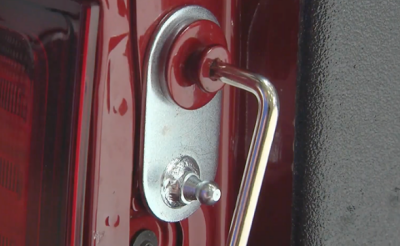

Using an M5 hex wrench and a 10mm wrench, install the threaded rivet (nutsert) into the opening located next to the tailgate pivot point. The threaded rivet requires at least 9 full turns to tighten. Please mark one side of the nut and count the rotations to ensure the correct number of turns is achieved. After 9 turns, if the threaded rivet still moves or spins, continue tightening it for an additional 1 to 2 turns. Re-inspect the threaded rivet and, if necessary, repeat the above steps. Once installation is complete, remove the threaded rivet installation tool.

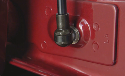

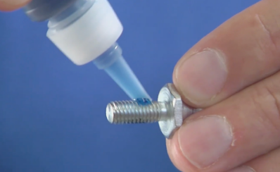

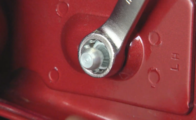

Use a 13mm wrench or socket to install the ball stud into the tailgate blind nut. Adhesive may be applied to the ball stud threads prior to installation; use a 13mm socket to tighten it to 8 ft-lbs of torque. Use a torque wrench to install the ball stud, ensuring the blind nut is fully seated.

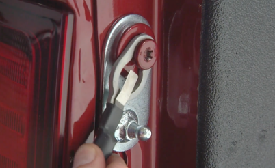

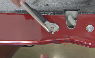

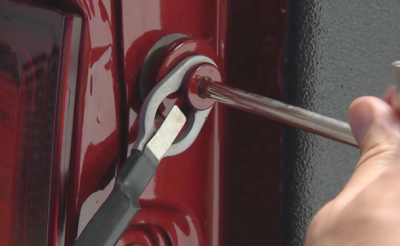

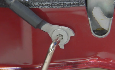

Remove the tailgate cable from its mounting bolt. Using a T45 Torx socket or the included wrench, remove the bolt securing the cable. Detach the tailgate cable from the bolt.
Insert the bolt removed in the previous step through the hole in the ball stud mounting plate, and thread it back into its original mounting hole. Use a T45 tool to tighten this bolt. Reattach the tailgate cable.

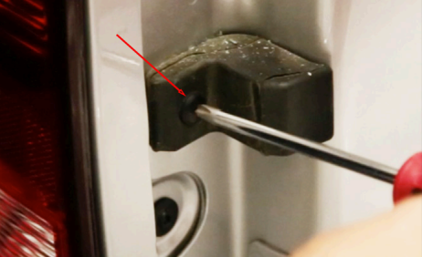

If a rubber bumper stop is present, remove it by prying it out while simultaneously rotating the screw.
Use a hammer and punch to flatten the metal stop tab, or simply remove the washer. This ensures that the cable can move freely—without binding—when closing the tailgate.

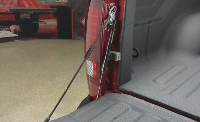

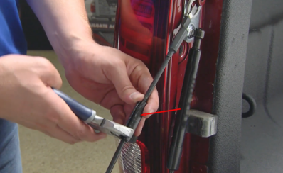

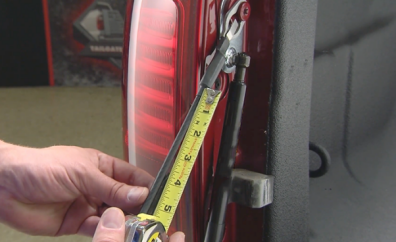

Measure 5 inches downward from the top of the cable. This marks the starting position for installing the cable clip. Use pliers to press and secure the clip onto the cable.

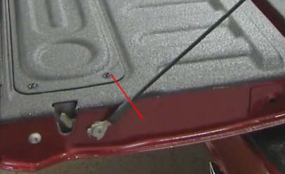

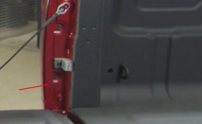

We have provided a polyester film to prevent components from sliding against the truck bed and tailgate. Please apply the polyester film to the truck bed and tailgate, particularly in areas where the tailgate's auxiliary components come into close proximity during the opening and closing process. The arrows in the diagram indicate the designated installation locations for the polyester film. The vehicle depicted in the diagram serves solely as an illustration of the polyester film installation; your specific vehicle may differ from the one shown.
Attach the thicker end of the shock absorber to the upper ball stud mount. Attach the thinner end of the shock absorber to the tailgate ball stud mount.
