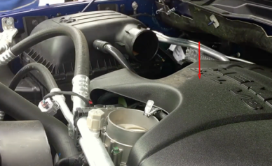

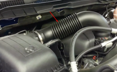

First, remove the intake manifold and engine cover.

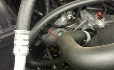

locating the original black plastic hose connecting the PCV valve and intake manifold. Press the clips on the connector and detach it from both ends.

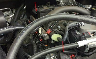

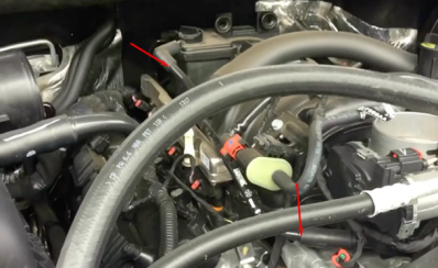

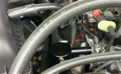

Secure the fuel separator to the pre-drilled hole at the front of the engine block using the included bolts and washers.

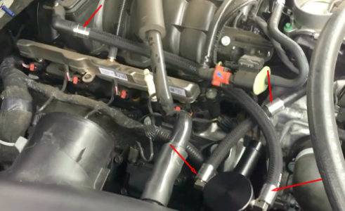

Slide the hose adapter into the PCV valve outlet and the connectors on the intake manifold that were previously removed from the hose, respectively. Connect one end of the new hose to the port on the fuel separator. Connect the other end of the new hose to the PCV valve outlet on the valve cover. Take another hose and connect one end to the port on the fuel separator. Connect the other end to the vacuum connector on the intake manifold that was previously removed from the hose.Secure the hose using the provided hose end.
Ensure all hose connections are secure and leak-free, then install the engine cover and intake manifold.
