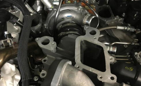

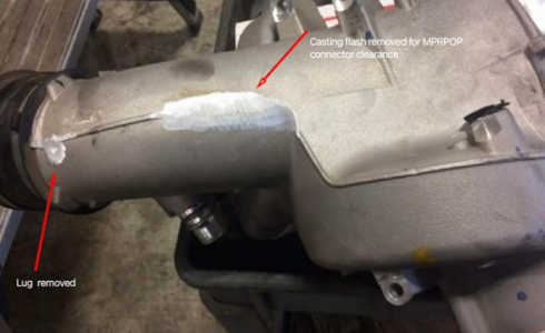

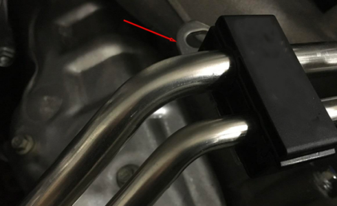

The aluminum manifold can then be removed. Depending on the situation, if it affects subsequent installation, the lugs at the bottom of the aluminum manifold should be cut off or ground flat to facilitate reinstallation.

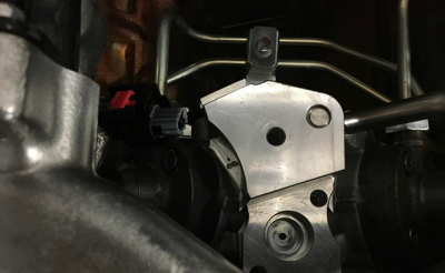

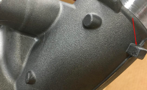

Depending on the specific circumstances, if the MProp connector is interfered with during reinstallation, the casting burrs in the area shown in the diagram should be removed.

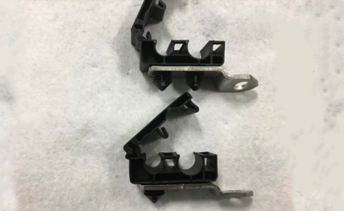

Remove the two rigid plastic clamps for the fuel supply and return lines, and set them aside.

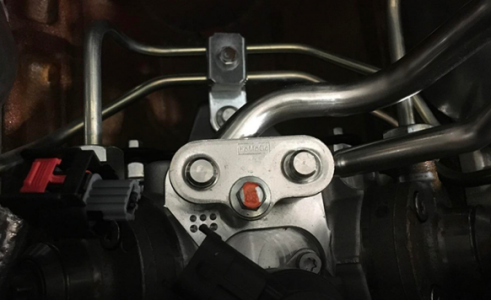

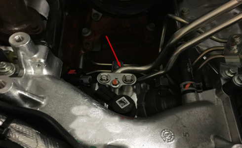

Once cleaning is complete, remove the circlips from the supply-side (left) and return-side (right) fittings, as shown in the diagram.

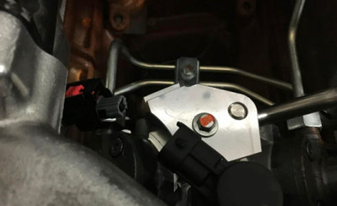

Loosen the 10mm flange bolts marked "FoMoCo" and then remove the "T-bar". This bolt will be used later to secure the fail-safe adapter.

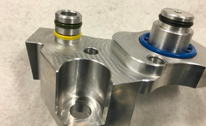

1.Remove the two O-rings from the fuel supply line and transfer them to the adapter block; alternatively, use the included new O-rings. Install the included O-rings onto the adapter block as shown in the diagram. Apply grease to the O-rings, then mount the adapter block onto the top of the high-pressure fuel pump.
2.Install the metering unit (FCA) into the adapter block and insert the included longer mounting bolts. Reinstall the central mounting bolt (i.e., the bolt originally used to secure the T-bar) and tighten all fasteners to the specified torque.

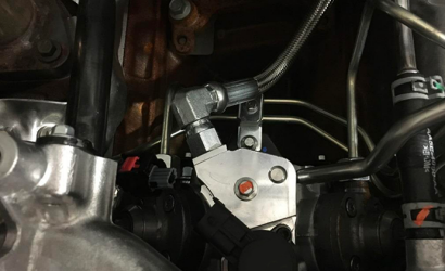

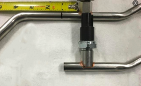

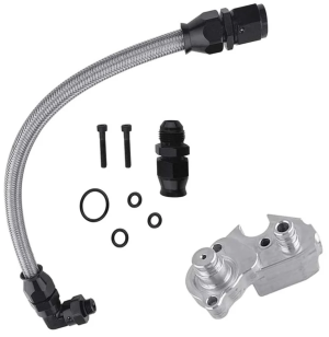

1.Remove the rigid fuel supply line and cut it at the location indicated in the diagram to facilitate connection with the accompanying stainless steel braided fuel line. Before tightening the compression fitting on the supply line, ensure that the cut surface is flat, perpendicular (at a right angle), and completely free of burrs. Once the fitting has been tightened onto the rigid line, inspect and clean the fitting to remove any fine debris.
2.The cut location for the fuel supply line should be selected approximately one inch away from the sensor closest to the high-pressure pump. Connect the end of the stainless steel braided line equipped with a compression fitting to the steel line. Apply a small amount of lubricant to the threads and load-bearing surfaces of the fitting to ensure smooth thread engagement.

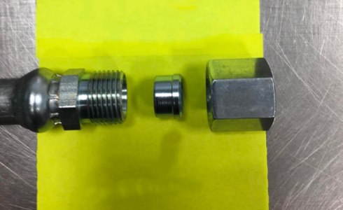

1.Please note the correct installation method for the ferrule on the tubing: the flanged end of the ferrule should face the nut.

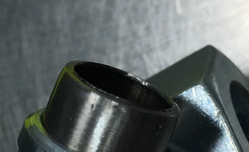

2.A pipe cutter creates a large, sharp burr on the inner wall of the pipe, which must be removed. These burrs can be effectively eliminated by using a wire wheel mounted on a bench grinder, in conjunction with a specialized deburring tool. Once the deburring process is complete, be sure to thoroughly clean the pipe.

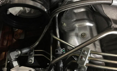

Note: this braided line must not touch any component as it is fit into the valley and run out.
The pipe bracket used to hold the supply and return water rigid pipes was modified to accommodate the new braided stainless steel tubing. This was achieved by removing a Christmas tree-shaped post near the bracket's mounting holes, allowing the plastic clips to rotate and avoid the crimping rings of the braided stainless steel tubing. The top remained unchanged, while the bottom was modified. This modification is required for both kit versions.
