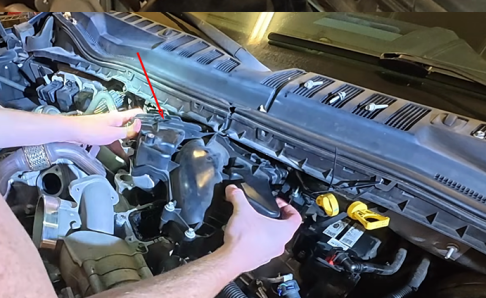

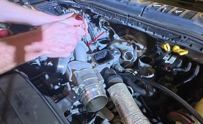

Remove the plastic upper intake manifold. Remove all fifteen 8mm bolts. Disconnect all electrical connections and wires from the intake manifold.

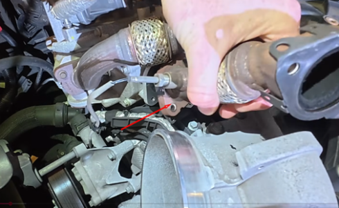

Remove the EGR hose between the cooler and the lower intake manifold. Keep the gaskets safe as they may be reused. Disconnect the electrical connections and remove the wiring harness clamps from the bottom of the lower intake manifold.

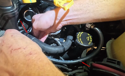

Remove the crankcase ventilation hose. Note that this hose may be fragile; handle with care to avoid damage.

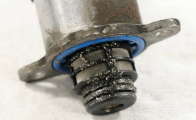

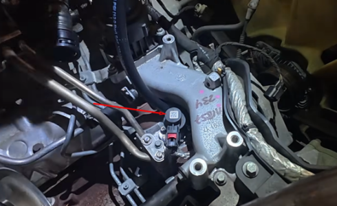

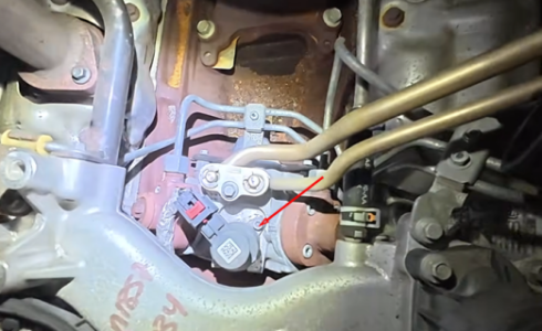

Remove the fuel control actuator (FCA).
Note: Before removing the FCA, thoroughly clean the area around the FCA with brake washer fluid and compressed air. After removing the FCA, ensure that no debris enters the fuel pump inlet.

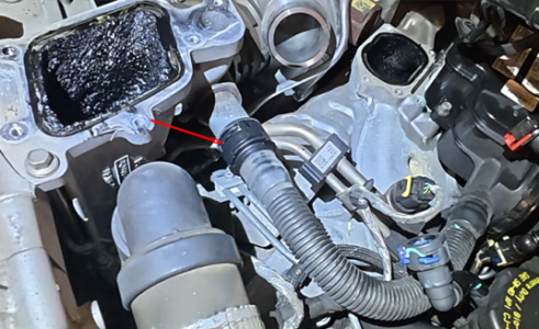

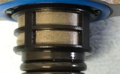

Check the metering unit for debris and ensure the fuel pump is functioning properly. If it is functioning properly, its condition should match the left diagram. If it resembles the right diagram, the fuel pump and fuel system must be replaced.

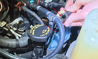

Remove the dust cover from the bypass hose assembly quick connector and blow the hose clean with compressed air, being careful not to damage the O-rings inside the quick connector. The hose was cleaned before shipping, but blowing it clean again ensures it is safe to use.
(For models manufactured in 2020 and later, please refer to steps 13 and 14. For other models, please skip these two steps.)

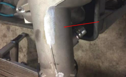

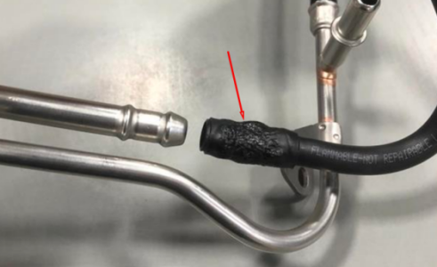

Remove the original plastic tubing and quick-connect assembly. The best method is to remove the original supply and return tubing assemblies, then soften the hose with a heat gun so it can be easily pulled off the original rigid tubing, as shown in the picture below.

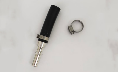

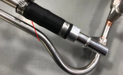

Install the included hose and quick-connect barb assembly.
1. Slide the hose onto the barb on the original supply tubing. Ensure there is no metal-to-metal contact between the aluminum fitting and the inner wall of the hose.
2. Tighten the hose clamp behind the second barb (see picture below).
3. Take special care to prevent foreign objects from entering the system.

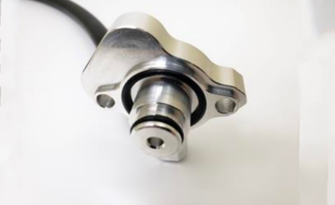

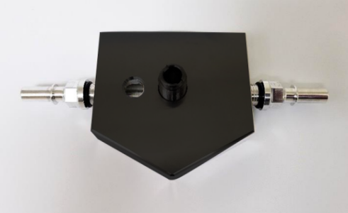

Install the large and small O-ring onto the Bypass Block.Push the o-ring into the groove to retain it.
Step 16:
Install Bypass Block and FCA onto the CP4 using supplied M5allen head bolts. Torque to 60 inch-lbs.

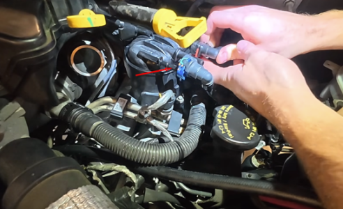

1. Carefully reinstall the crankcase ventilation hose to the lower intake manifold.
2. Remove the original fuel line from the lower rigid hose.
3. Push the quick-connect fitting into the corresponding hooks until you hear a click. Gently pull to ensure it is fully in place.
4. Using the provided cable tie hose clamps, adjust as needed to ensure the hose does not rub against nearby components.

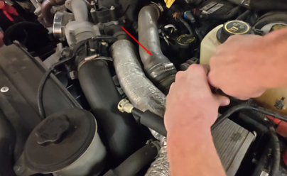

Install hot side compressor outlet to intercooler pipe.

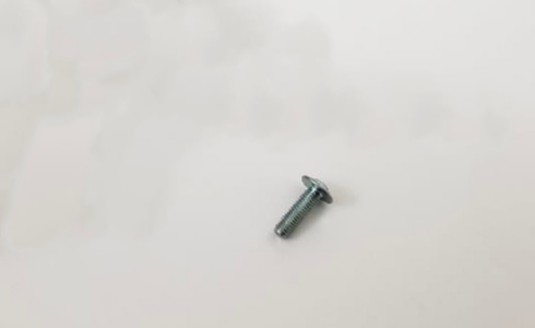

Use short round head bolts - no washers or gaskets required.

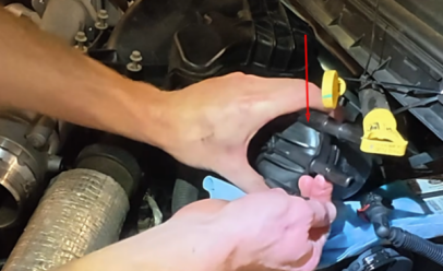

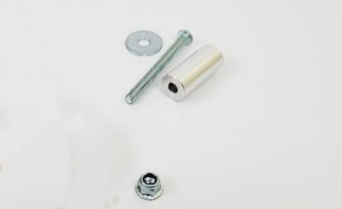

1. Loosen the hood to install the fuel filter.
2. Remove the plastic fastener from the hood.
3. Place the washer over the long bolt. Pass the provided long bolt through the hole, then through the gasket, and finally through the fuel filter bracket. Tighten the provided nylon lock nut.

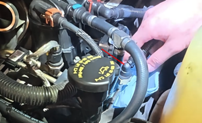

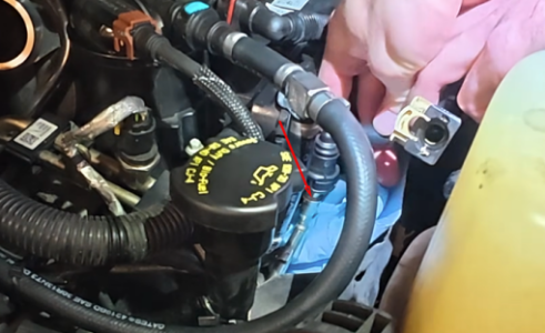

1. Place some absorbent towels around the connector to collect diesel fuel.
2. Remove the quick-connect coupling from the original metal return connector.
3. Holding the original plastic tubing, rotate the plastic female quick-connect coupling inside the molded tubing 180 degrees so that it faces upwards. Fine-tuning may be required afterwards.
Step 26:

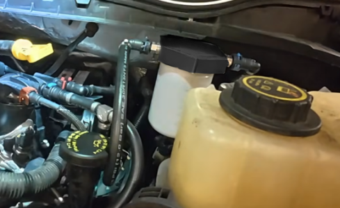

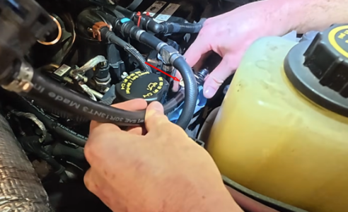

Install the hose with plastic connectors at both ends. Connect the larger quick-connect coupling to the original metal return connector from which the original connector was previously removed. Wrap the hose around the back of the filter, and connect the plastic quick-connect coupling to the right side of the filter head.
Step 27:
Install the included cable tie hose clamp. Wrap the cable tie around the original fuel supply line and clamp the hose onto the cable tie, adjusting as needed to ensure the hose is away from the brake booster and reservoir.

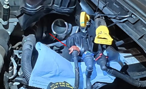

Install the shorter left-side hose by inserting the aluminum barb into the previously disconnected and rotated-up original quick connector. Connect the other end to the left side of the filter head. Adjust the rotation angle of the quick connector as needed to avoid wear.
Step 29:

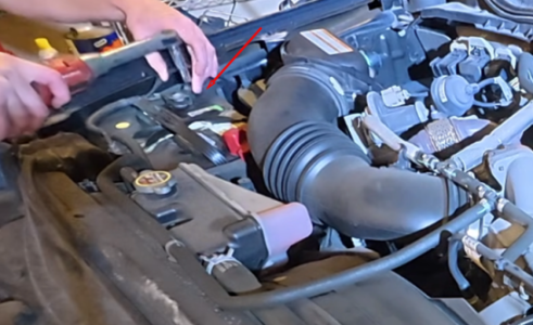

First, disconnect the positive and negative terminals of the main battery and the backup battery.

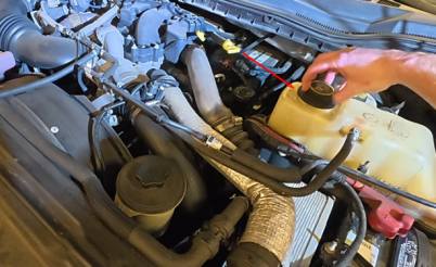

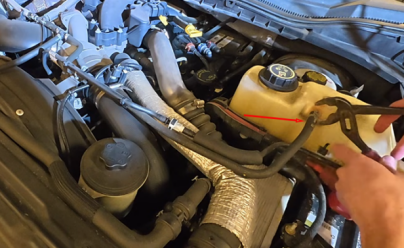

Remove the radiator cap to release pressure and disconnect the coolant lines covering the top of the radiator to make room for further operations.

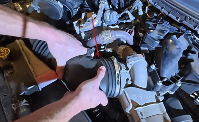

Disconnect the vacuum lines and remove the mass airflow meter (MAF), intake box, and vacuum lines.
