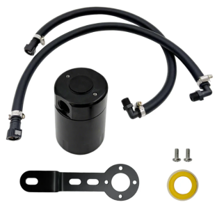

This is the installation process for the ER-0311: 2014-2018 5.3L 6.2L Chevy GMC 1500 Tahoe Yukon Oil Catch Can Separator Kit,provided for your reference during installation.

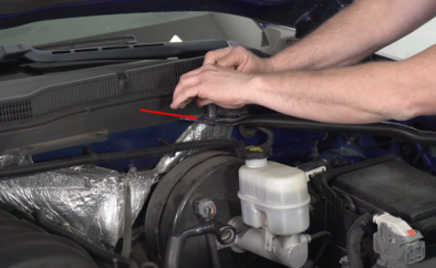

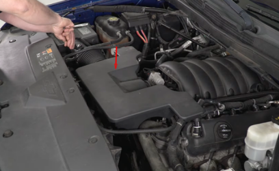

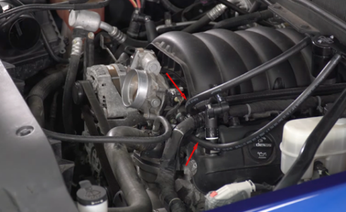

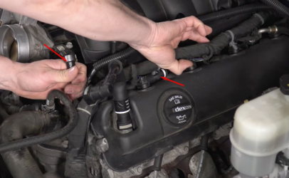

First, remove the intake manifold cover and locate the original black plastic hose connecting the PCV valve and the intake manifold. Press the clips on the connector and detach it from both ends.

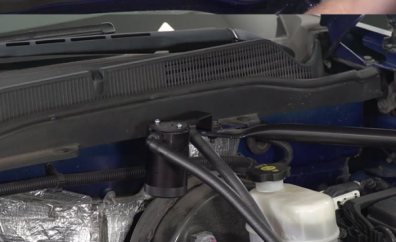

Locate the driver's side firewall bracket bolt in the engine compartment. Remove the screw, attach the matching bracket to it, and then attach the fuel separator to the bracket.
Connect one end of the new hose to the "IN" port of the fuel separator. Connect the other end of the new hose to the PCV valve outlet on the valve cover. Take another hose and connect one end to the "OUT" port of the fuel separator. Connect the other end to the vacuum connector on the intake manifold from which the rigid hose was previously removed.
Ensure all hose connections are secure and leak-free, secure them with clamps, and reinstall the intake manifold cover.
