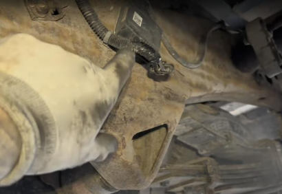

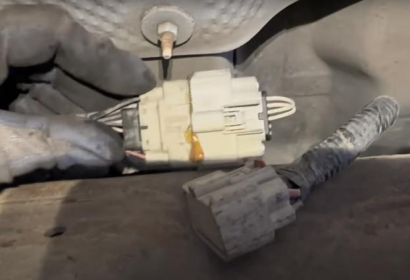

Find the plug on the lower internal frame rail at the rear of the truck and unplug it, then clip one of the black plugs provided in the kit onto the factory socket port.
Note:Before installation, some electrical grease can be applied to prevent corrosion.

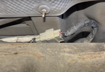

Find the second plug along the external frame guide rail. Before removing the plug, pop out the red label and fasten the black plug of the kit to the factory plug port.

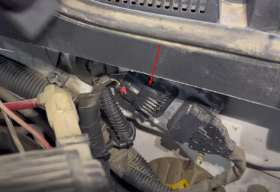

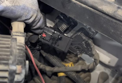

Find the third plug under the hood on the driver's side along the firewall, and clip the black plug of the kit onto the factory plug port.

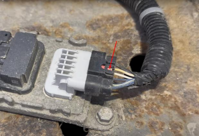

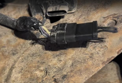

On the passenger side of the truck, between the exhaust and frame, you may need to remove the exhaust pipe to find it. Similarly, before removing the plug, the red label needs to be popped out.disconnect the white plug above the torsion bar, and install the CANBUS plug.
