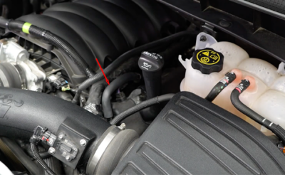

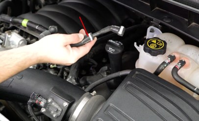

First, locate the original black plastic hose connecting the PCV valve and the intake manifold. Press the clips on the connector and detach it from both ends.

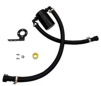

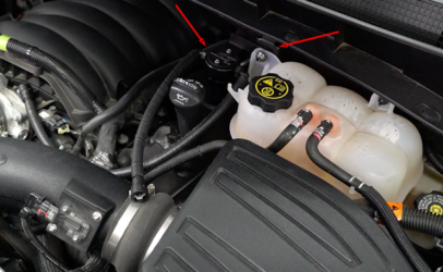

Use the original mounting bolts from the auxiliary water tank to install the metal bracket. First, remove the auxiliary water tank mounting bolts, attach the matching bracket to the bolts, and then attach the fuel separator to the bracket.

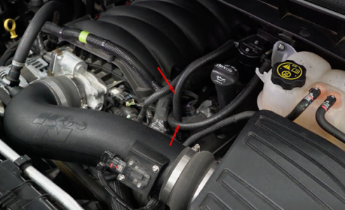

Connect one end of the new hose to the "IN" port of the fuel separator. Connect the other end of the new hose to the PCV valve outlet on the valve cover. Take another hose and connect one end to the "OUT" port of the fuel separator. Connect the other end to the vacuum connector on the intake manifold from which the rigid hose was previously removed.
Ensure all hose connections are secure and leak-free.
