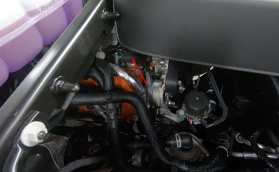

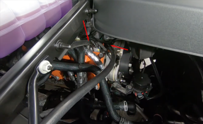

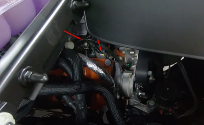

First, locate the original black plastic hose connecting the PCV valve and the intake manifold. Press the clips on the connector and detach it from both ends.

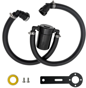

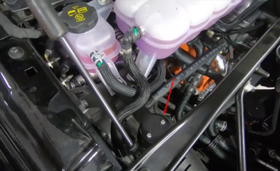

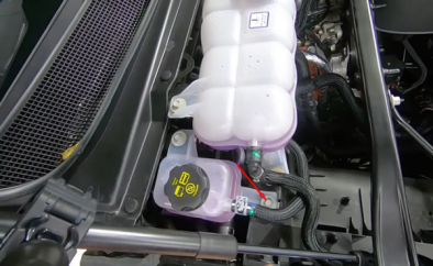

Install the metal bracket using the auxiliary water tank mounting bolts. First, remove the auxiliary water tank bolts, install the matching bracket onto the bolts, and then install the fuel separator onto the bracket.

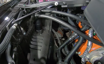

Connect one end of the new hose to the "IN" port of the fuel separator. Connect the other end of the new hose to the PCV valve outlet on the valve cover. Take another hose and connect one end to the "OUT" port of the fuel separator. Connect the other end to the vacuum connector on the intake manifold that was previously removed from the rigid hose.
Ensure all hose connections are secure and leak-free.
