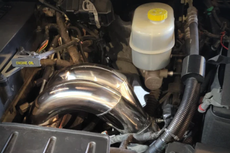

- Upgrade the Intake Elbow: Replacing the restrictive factory elbow is one of the most cost-effective mods you can do. A quality aftermarket elbow, like this high-flow intake elbow, features mandrel-bent, smooth-walled construction (typically T304 stainless steel) to improve airflow by up to 50% over stock. This directly translates to a sharper throttle response as the turbo can draw air more easily.

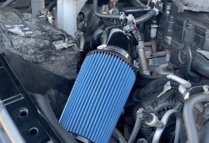

- Install a Cold Air Intake (CAI): Next, replace the entire airbox assembly. A true CAI system, such as this cold air intake kit for 2007.5-2012 Rams, does two critical things: it uses a high-flow, dry-cone filter for less restriction, and it's engineered to draw cooler air from outside the hot engine bay. Cooler, denser air improves combustion efficiency, which supports power gains and helps lower EGTs.

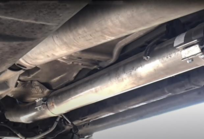

- The Essential DPF Delete: For 2007.5-2012 pickup trucks (note: not Cab & Chassis models), the fundamental upgrade is installing a DPF delete pipe. This DPF delete race pipe replaces the massive, restrictive factory filter canister with a straight-through section of T-409 stainless steel piping. The results are immediate: drastically reduced backpressure, faster turbo spool, and most importantly, EGT reductions of 200-400°F under load, greatly enhancing engine longevity.
- The Ultimate Exhaust Solution: For the pinnacle of exhaust flow—especially on 2010-2012 trucks—a full turbo-back system is the answer. This 4" turbo-back DPF delete pipe replaces the entire exhaust from the turbo outlet backward, ensuring maximum flow from the very first inch. It offers the greatest performance gains and a more authoritative exhaust tone.
