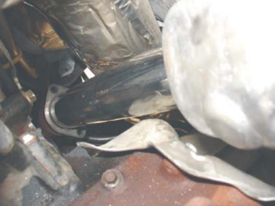

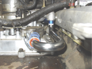

Option B: The "Full Delete" (What I Installed)
I decided to go all the way. I wanted the EGR valve gone and the airflow restriction removed completely. I installed the full EGR delete kit with high-flow intake elbow.- Construction: This kit is legit. It uses a 304 Stainless Steel up-pipe (the part that connects to the exhaust) and a billet aluminum block-off plate.
- Why this wins:
- Airflow: By removing the internal scoop in the up-pipe, you increase exhaust flow to the turbo.
- Lower Temps: Without hot exhaust gas being recirculated into your intake manifold, your Intake Air Temps (IAT2) drop significantly.
- Cleanliness: No more soot building up in your intake manifold. If you’ve ever pulled a stock 6.0L intake, you know it looks like a chimney inside. This kit stops that.

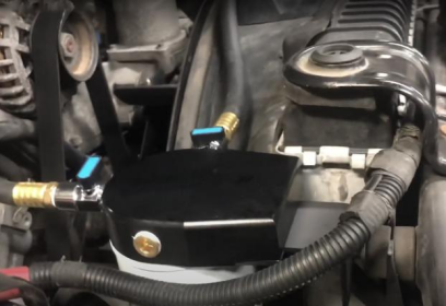

Option C: The Preventive Measure (Coolant Filtration)
You cannot fix the EGR/Oil Cooler issue without addressing the root cause: the dirty coolant. While I had the system drained, I installed a coolant filtration filter kit.- Why you need it: This is a bypass filter that catches the casting sand and sediment I mentioned earlier.
- The Design: It mounts neatly in the engine bay (usually off the radiator support) and uses silicone hoses. The filter block is surface hardened and polished aluminum.
- Life Expectancy: You will be shocked at how much "mud" this catches in the first 500 miles. It protects your new oil cooler and water pump.

This is not a 30-minute job. Plan for a full weekend. Here are the critical things I learned during the install:1. The Turbo Bolts (The Nightmare)To install the full delete kit, you have to access the up-pipes behind the turbo.
- Tip: Spray the turbo mounting bolts and V-band clamps with PB Blaster 24 hours before you start.
- Tip: You usually need to remove the turbo to get the new stainless up-pipe seated correctly. Don't fight it—just pull the turbo. It gives you a chance to clean the VGT vanes anyway.
- Caution: When you lift the manifold, be extremely careful not to knock dirt or debris into the intake ports on the head. Vacuum the area before you lift the manifold.

- Tip: Install the ball valves included in the kit properly. You want to be able to shut off flow to the filter so you can change the filter element without draining the whole system later.
