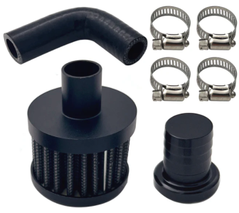

If you’ve decided you want cleaner intake air and are willing to accept the tradeoffs, here are your options—and the specific complications this generation introduces.Path 1: Full Atmospheric Reroute (Vent to Air)
This is the simplest modification. You remove the factory CCV hose from the intake tube, cap the intake port, route a hose from the valve cover outlet down the frame rail, and terminate it with a small filter or simply point it downward.
Pros:
- Zero oil enters your intake system
- Eliminates intercooler and turbo contamination completely
- Cheap ($30-50 for hose and fittings)
- DIY-friendly
- ECM WILL notice. The crankcase pressure sensor is still active. If you remove the factory filter assembly entirely, you’ll get P1507/P1508 codes and a check engine light .
- Odor. Multiple owners report a distinct “burnt diesel/oil” smell at idle, especially with windows down or when the vent terminates near the cab .
- Drips. In cold weather, condensation mixes with oil vapor and drips from the hose end.
- Illegal for on-road use. Venting crankcase emissions to atmosphere violates EPA regulations. Enforcement is rare, but it’s a non-compliance modification .

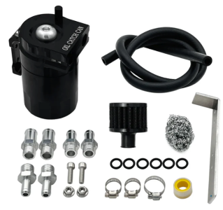

Path 2: Catch Can Installation
A catch can installs between the CCV outlet and the intake inlet. It uses baffles, mesh, or centrifugal force to condense oil vapor, collecting liquid in a reservoir while allowing “cleaned” air to continue to the intake.
Pros:
- Retains closed crankcase ventilation (emissions compliant)
- Reduces—but does not eliminate—oil entering the intake
- No external odor or drips
- No check engine light if you retain the factory filter housing
- Maintenance. You have to empty the can. If you forget, it becomes useless.
