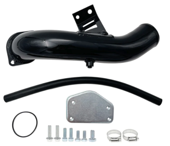

The goal of this kit: Remove the entire EGR assembly—cooler, valve, feed pipe—and replace it with three things: a block-off plate for the exhaust manifold, a coolant bypass hose to keep the cooling system sealed, and a high-flow intake elbow that actually improves airflow.
Nickel-Plated Steel Exhaust Block-Off Plate
This seals the exhaust manifold port where the EGR feed pipe originally connected. The nickel plating matters—raw steel rusts, and rust flakes find their way into threads. This won’t.
17-Inch Coolant Bypass Hose (430mm)
Once the EGR cooler is removed, the two coolant hoses that fed it need to be connected. This pre-cut silicone hose does exactly that. It’s the correct length, and the included constant-tension clamps actually seal.
High-Flow Intake Elbow
Cast aluminum, not plastic. The factory LLY elbow is restrictive and heat-soaks quickly. This replacement has a smoother internal bore and polished exterior. It’s not just functional—it looks like an upgrade.
O-Ring & Hardware
One rubber O-ring for the intake elbow, two hose clamps, and a full complement of bolts: M10 x M20 hex head, M8 x 30mm Allen bolts, M10 x 30mm hex bolts, M8 x 20mm hex bolts. You won’t be digging through your spare bolt bin at 10 p.m.
Part 2: What’s in the Box
The TruckTok LLY EGR Delete Kit arrives in a box that’s heavier than you expect. Here’s exactly what comes with it:Nickel-Plated Steel Exhaust Block-Off Plate
O-Ring & Hardware
