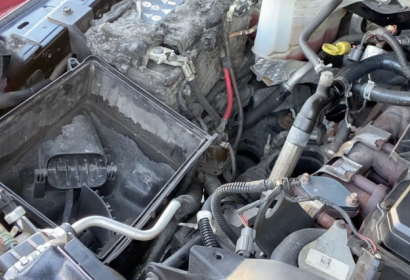

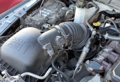

Disconnect the intake temperature/MAF sensors, the CCV hose, and remove the stock airbox and tube

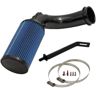

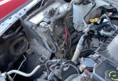

Remove the original air filter housing, insert the intake pipe into the vehicle interior, and then use the brackets provided in the kit to fix the intake pipe.

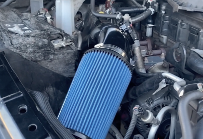

Install the new air filter onto the intake pipe, and move the air temperature sensor from the original intake port to the new pipe.
Final Check: Ensure all clamps are tightened and no parts touch the engine or other components.
