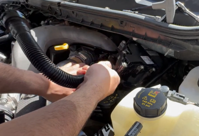

This is the installation process for the ER-0091: 2011-2023 6.7L Ford Powerstroke CCV/PCV Reroute/Delete Engine Ventilation Kit, for your reference during the installation process.
1.Remove the intake pipe of the Charge Air Cooler .
Note: Even the smallest turbocharger compressor blades may be damaged grain.
2.Pull the spring clip until the end of the spring clip is located in the pawl of the quick connect connector.Release the clamp and remove the CAC intake pipe.

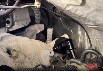

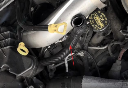

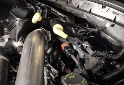

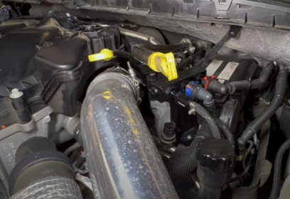

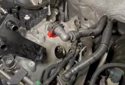

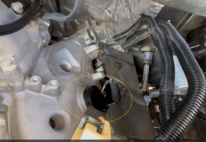

1.Release the fixing lug of the crankcase ventilation oil separator outlet hose, and if necessary, break the fixing lug. Disconnect the crankcase ventilation oil separator outlet hose from the lower intake manifold. Attention: Use a cloth to catch the leaked oil from the oil separator.
2.Remove the bolts of the crankcase ventilation oil separator, and then remove the crankcase ventilation oil separator.

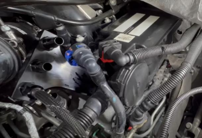

Install the unit on to the breather port on the rear of the engine where you removes the stock unit.“Be sure to clean any old oil residue,now torque 2bolts evenly too 96 lb in.

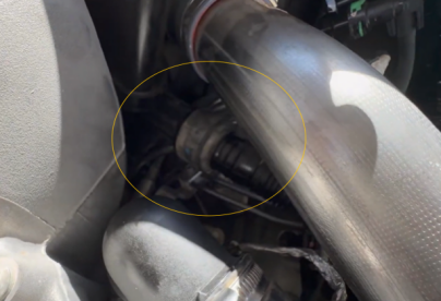

Removed the ventilation hose from the factory and installed the cover device provided in the kit onto the inlet port, which can be secured with clamps. Even if there is no pressure behind it, it does not need to be fixed.
