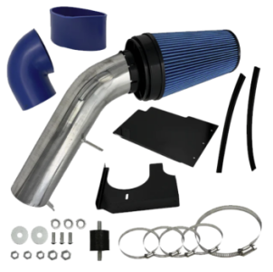

This is the installation process for the IA-0004: 1999-2003 7.3L Ford F250 F350 Cold Air Intake Kit,provided for your reference during installation.

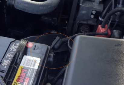

Park the vehicle on a level surface, allow the engine to cool, and disconnect the negative terminal of the battery.

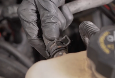

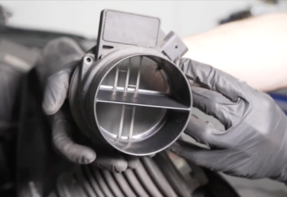

Disconnect the air flow sensor connector. Then use a wrench to remove the sensor.

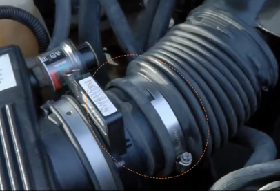

Loosen the clamps on the top of the air filter box cover. Use a wrench to loosen the hose clamps between the hose and the air filter box, then remove the cover.
Remove the bolts securing the lower part of the air filter box and remove it from the vehicle.
Remove the original intake hose.

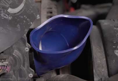

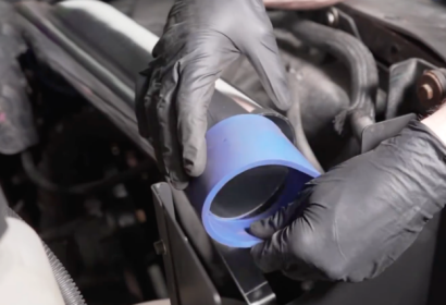

Fit the new rubber connecting sleeve onto the throttle body's intake port and tighten it with the clamp.

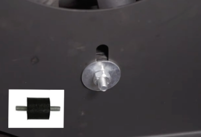

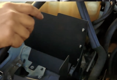

Install the matching intake pipe bracket and sensor bracket at the bottom.

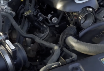

Place the new Air Intake Pipe over the previously installed rubber connecting sleeve on the throttle body, tighten the clamps, and secure the lower part to the bracket with bolts, ensuring the pipe is secure and sealed.

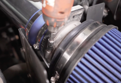

Place the filter element onto the new Air Intake Pipe and clamp it with the matching clamps, ensuring a tight seal.

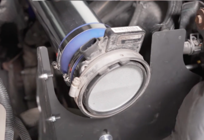

Secure the air flow sensor to the sensor bracket, ensuring it is secure.
