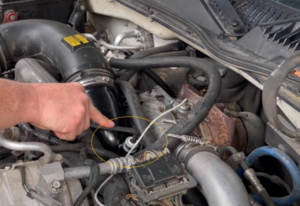

Unscrew the hose clamps and V-band clips that secure the two bent pipes at the turbine inlet and remove the turbine inlet bend.

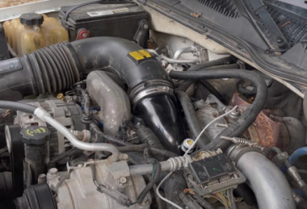

Reinstall the turbine intake elbow, aligning the larger end with the turbine inlet and continuing to tighten the other end with the inlet using a clamp.Note: keep the turbine inlet clean to prevent impurities from entering the turbine.

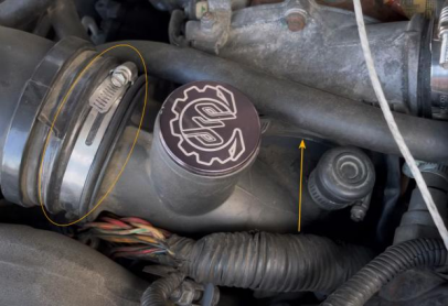

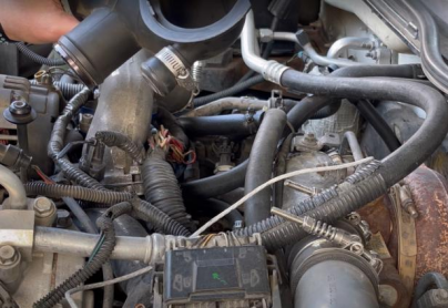

Use an eight millimeter hex wrench to tighten the plug on the turbine intake elbow to prevent leakage.
