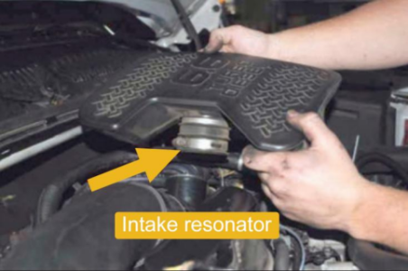

3.Remove intake resonator by loosen hose clamp and Suppor bolt.

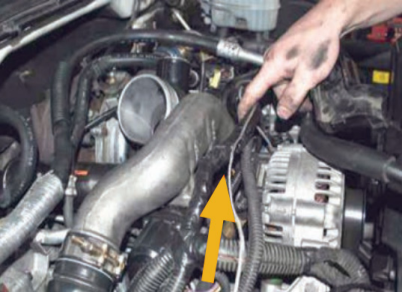

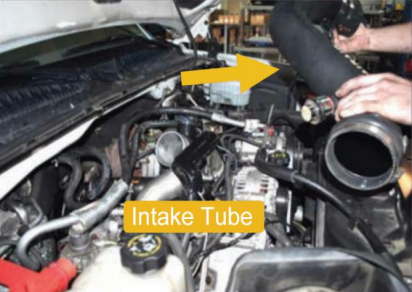

1.Disconnect the mass air flow sensor. Remove the intake tube by loosening the hose clamps on the intake tube.
2.Remove the zipper and unplug the wire from the intake pipe.

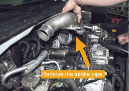

1.Remove the intake pipe fixed by one hose clamp and six bolts.
Note: keep debris out of the intake system.

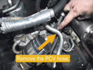

2.Remove the PCV hose on the passenger side of the truck.

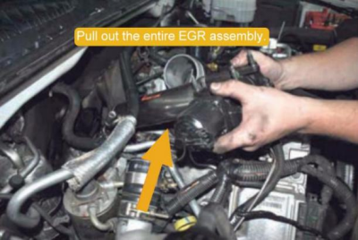

Remove the 4 bolts and nuts that secure the EGR valve to the motor.Disconnect all coolant lines leading to the EGR cooler.
Now the entire EGR assembly can be pulled out. Be sure to keep the exhaust gasket for install the baffle.

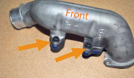

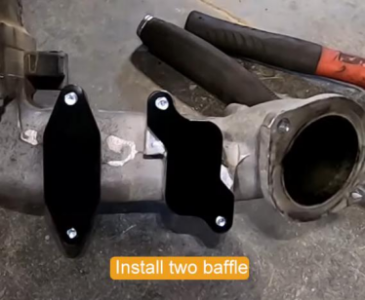

Pre install the charging tube using the provided baffle with O-ring.
Note: Be sure to install two longer bolts on the front side of the pipe.

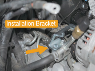

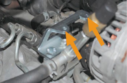

Install the provided bracket onto the motor using a factory bolt and the M10 x 20 hex head bolt provided in the kit.

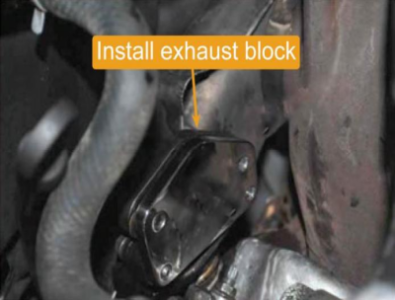

Install the exhaust block using the provided 20mm and 30mm bolts. All bolts will be installed from the back of the baffle.

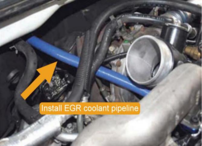

Replace the EGR coolant pipeline with the provided coolant pipeline. This will reconnect the coolant from the return pipe to the thermostat.
Re-install intake tube with the front long bolts going through the previously installed support bracket.
Reverse earlier steps to re-install the pcv hose, electrical wires, intake and intake resonator.
