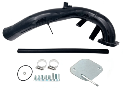

This is the installation process for the ER-0026: 2006-2007 6.6L Chevy Silverado Classic GMC Duramax LBZ Diesel EGR Delete Kit, provided for your reference during installation.

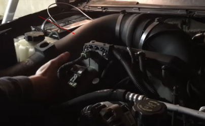

2. Drain the coolant.

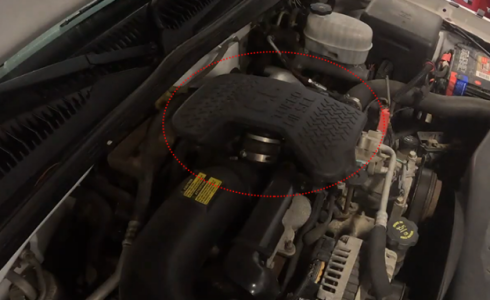

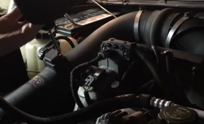

3. Remove intake resonator By loosening hose clamp and Suppor bolt.

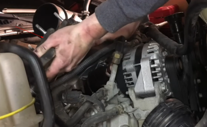

1.Disconnect the mass air flow sensor. Remove the intake tube by loosening the hose clamps on the intake tube.
2.Remove the zipper and unplug the wire from the intake pipe.
1.Remove the intake pipe fixed by one hose clamp and six bolts.
Note: keep debris out of the intake system.

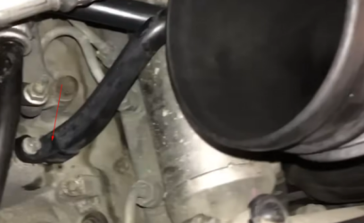

2.Remove the PCV hose on the passenger side of the truck.

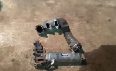

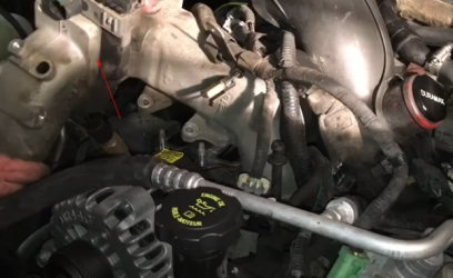

Remove the 4 bolts and nuts that secure the EGR valve to the motor. Disconnect all coolant lines leading to the EGR cooler. Now the Entire EGR assembly can be pulled out.

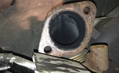

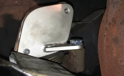

Install the exhaust block using the provided 20mm and 30mm bolts. All bolts will be installed from the back of the baffle.

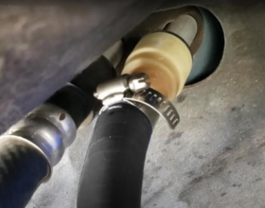

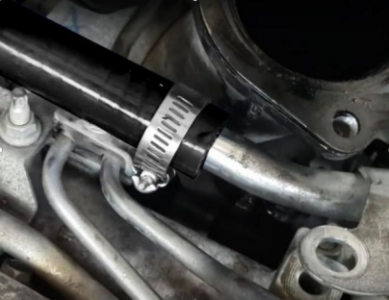

Replace the EGR coolant pipeline with the provided coolant pipeline. This will reconnect the coolant from the return pipe to the thermostat.

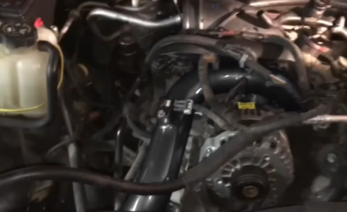

Install the new intake pipe onto the engine.
Add the coolant in the reverse order, reinstall the intake pipe, PCV hose, wiring, etc., and check for any leaks.
