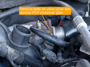

2.Loosen all 6mm bolts on the valve cover and loosen the hose clamp located in the center, then remove the PCV crossover pipe. Keep the bolts in place and they will be used later.

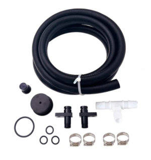

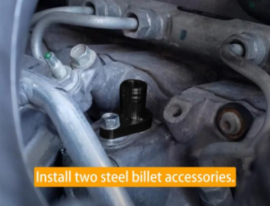

The installation kit provides two steel billet accessories. The O-ring end will be installed in the valve cover. It is best to apply a little oil on the O-ring for easy installation.

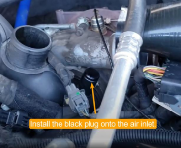

Insert the black plug provided in the kit into the air intake and secure it with a zip tie.

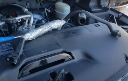

The advisable method for routing the hoses is to position both of them in the wheel compartment on the passenger side. By doing so, potential odor problems associated with placing hoses on the driver's side within the cab can be minimized. Measure accurately and cut a supply hose to a length of 5.5 feet.

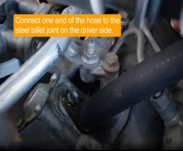

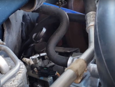

1.Connect the longer hose to the steel billet joint on the driver side and connect it with the provided hose clamp. As shown in the above figure, arrange the hose behind the air pipe.

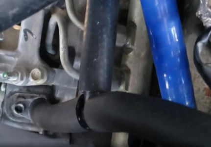

2.Connect the shorter hose to the passenger side connector and connect it with the accompanying hose clamp. Connect the two hoses together with zip ties and run them parallel as shown above.

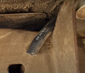

1.Guide the hose through the outer side of the frame and extend it to the wheel cover area at the rear of the upper control arm. Ensure that the hose is arranged along the outer side of the frame to effectively avoid and clean the exhaust system.
2.Next, use two zip ties to securely fasten the two hoses to the torsion bar. Subsequently, trim the hose to an appropriate length, ensuring that its end is located approximately 2 inches below the torsion bar. Finally, simply reinstall the intake pipe and muffler according to the instructions in step 1, and then you can drive the vehicle. Please note that this product is specifically designed for use in off-road environments.
