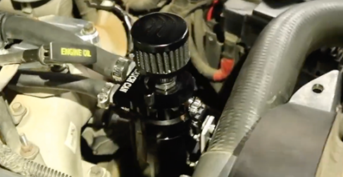

I installed the TruckTok Universal Aluminum Oil Catch Can (300mL version), and the process and results were so enlightening, I had to share. This isn't just another shiny billet accessory; it’s functional preventative maintenance.

Think of a catch can as a “middleman” in the PCV system. It sits inline between the crankcase breather/PCV outlet and the intake manifold. Its sole job is to cool, condense, and collect the oil vapor and contaminants, letting only cleaner gases proceed to the engine.Why I Chose the TruckTok 300mL Aluminum Can:
- Material: Aerospace-grade aluminum alloy is perfect. It's lightweight, disperses heat efficiently (helping condensation), and looks the part. No cheap plastic here.
- Capacity: 300mL is a great sweet spot for most street and moderate performance applications. Big enough to not need constant emptying, small enough to fit in tight engine bays.
- Design Features: The anodized body resists corrosion. The 3/8" & 9/16" hose adapters covered most universal hose sizes. The built-in dipstick is a genius, no-mess way to check the fluid level without disassembly. But the real gem is the removable baffle/plate. This isn't just a simple empty can; the baffle forces the vapor to change direction, maximizing condensation. You can also pack it with stainless steel or bronze filter media (like a Scotch-Brite pad) for even better filtration.

- Understand Your PCV Flow: This is vital. You must identify the dirty side (line coming FROM the crankcase/valve cover) and the clean side (line going TO the intake manifold). The catch can MUST be installed on the dirty side. Intercepting the clean side does nothing. Research your specific engine’s PCV routing.
- Cutting & Routing Hoses:
- Carefully cut the existing dirty side PCV hose.
- Route new hoses from the crankcase OUTLET to the INLET of the catch can.
- Route a hose from the OUTLET of the catch can to the INTAKE MANIFOLD inlet.
- Keep hoses as short and direct as possible, avoiding sharp bends. This maintains proper crankcase ventilation.
- Secure Everything: Use proper hose clamps on every connection. Vibration is the enemy. Secure the hoses with zip-ties or loom away from moving parts/belts.

I’ve run the TruckTok can for about 3,000 miles now. Here’s the honest breakdown:The Good (The “Holy Smokes, It Works” Moments):
- Visible Proof: Draining that first 100mL of foul, watery oil sludge was all the validation I needed. That was 100mL of intake-gunking, octane-lowering garbage taken out of the equation.
