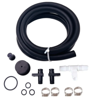

The TruckTok CCV PCV Reroute Ventilation diesel Kit we're looking at is designed specifically for the 2004-2010 Duramax platform and takes a comprehensive approach. It's not just a hose; it's a complete replacement system.- Durable, Direct-Fit Components: The main fittings are made from black anodized aluminum alloy, which resists corrosion and looks clean under the hood. The kit includes two billet fittings that replace the stock plastic ports on the valve covers, two plugs to seal the old ports on the intake system, and a length of durable 5/8" CCV/fuel hose (which is oil-resistant and lasts much longer than standard heater hose).
- The Core Function - Reroute and Vent: The kit completely removes the restrictive factory plastic crossover tube. You install the new aluminum fittings on each valve cover. Then, you run the supplied hose from these fittings, down along the frame (typically on the passenger side to avoid cab odors), and let it vent near the wheel well. This eliminates the path for oil vapor to enter your turbocharger.

I'll be honest, this is one of the easier mods you can tackle. I did it in my driveway in about two hours taking my time. The instructions provided are a good guide, but here's the real-world process and a couple of tips I picked up:- Gaining Access: Start by removing the main intake pipe from the airbox to the turbo. This gives you clear access to the valve covers and the factory PCV crossover pipe that runs across the top of the engine.
- Removing the Old System: Loosen the six 6mm bolts holding the factory plastic crossover pipe to the valve covers, and loosen the hose clamp in the center. Carefully remove the entire assembly. Keep the bolts—you'll use them again. You'll now see the two round ports on the intake where the old system connected.
- Installing the New Fittings: Take the two anodized aluminum fittings from the kit. As the instructions suggest, putting a tiny dab of clean oil on the O-rings makes them slide into the valve cover ports much more smoothly. Hand-tighten them, then use the original bolts to secure them firmly.
- Sealing the Intake: This is a satisfying step. Take the two black plugs from the kit and firmly press them into the now-empty ports on the intake manifold and intake elbow. I used a zip tie around one for extra peace of mind, ensuring it would never pop out.
- Routing the Hose (The Most Important Part): Measure and cut the supplied hose. The instructions wisely advise routing it down the passenger side frame rail, behind the upper control arm, and letting it vent near the wheel well. This is key—routing it down the driver's side can sometimes lead to fumes being drawn into the cab through vents. Use the provided zip ties to secure the hose well away from the exhaust and moving parts. I trimmed mine so the end sat just below the torsion bar, as recommended.
