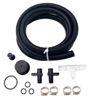

What a quality LMM kit includes:
  • Anodized aluminum fittings that replace the factory plastic ports on each valve cover
  • Two port plugs to seal the intake tube openings
  • A resonator plug for the intake elbow (if equipped)
  • 5/8” oil-resistant hose (CCV/fuel hose, not standard heater hose)
  • Flange clamps and hardware

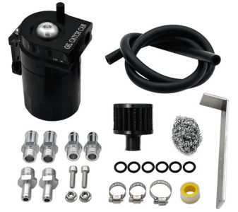

Path 2: Catch Can (Closed System)
A catch can installs between the valve cover outlet and the intake inlet. It uses baffles or mesh to condense oil vapor, collecting liquid in a reservoir while allowing “cleaned” air to continue to the turbo inlet.
Pros:
  • Retains closed crankcase ventilation (emissions compliant).
  • No external odor or drips.
  • Reduces—though does not eliminate—oil entering the intake .
Cons:
  • Most affordable catch cans are undersized. A $60 can with steel wool inside will fill quickly and become a restriction.
  • Maintenance. You must empty the can. If you forget, it becomes ineffective.
  • Real-world effectiveness varies widely. High-quality units work well but cost significantly more and require fabrication.

Part 5: Installation Reality – It’s Easier Than You Think​
A CCV reroute on the LMM is genuinely a one-hour job with basic hand tools .
Basic steps:
  1. Remove the intake tube from the turbo inlet mouthpiece.
  2. Disconnect the factory CCV hose from the turbo inlet and from both valve covers. The driver’s side requires removing the intercooler tube for access .
  3. Install the new anodized fittings into the valve cover openings. A light coat of oil on the O-rings helps them seat properly.
  4. Install the provided plugs into the turbo inlet and intake elbow openings.
  5. Cut the supplied hose to length and route it from the fittings down the passenger side frame rail.
  6. Secure with zip ties, away from exhaust components and moving parts.
  7. Reinstall the intake tube.
Two critical details specific to the LMM:
  • The intake resonator plug. The LMM intake elbow has a small resonator chamber on the driver’s side. The kit includes a dedicated plug for this opening. Do not skip it .
  • Hose routing. Route both hoses together down the passenger side. Routing down the driver’s side increases the chance of cab odor due to HVAC intake location.
Torque specs? None. Clamps are hand-tightened until snug. Overtightening can crack the aluminum fittings.
