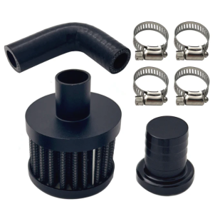

The fix is elegantly simple: intercept those harmful vapors before they reach the intake and vent them safely to the atmosphere (or to a catch can first). This converts the problematic closed system into a reliable open system. The specific TruckTok CCV Black Crankcase Ventilation Open Breather Kit I installed is a perfect example of this solution done right.
What's in the Box & Key Features:
This isn't some janky parts-store special. The quality is immediately apparent:
- Reinforced Silicone Hoses: Not cheap rubber that will crack and degrade. These are thick, temperature-resistant silicone hoses. The kit prominently features the 90-degree ventilation hose – this angle is crucial. It's designed not just to route vapor, but to help drain separated oil condensate back toward the crankcase, preventing pooled liquid in the line.
- Proper Fittings and Clamps: All included hose clamps are constant-tension or high-grade worm-drive clamps. No leaking at the connections.
- Breather Filter (Optional on some kits): The end of the line is a small, cleanable filter that allows vapors to escape but blocks debris. Some kits vent to a catch can first; this one goes straight to atmosphere, which is simpler and effective for most users.

- Use pliers to remove the hose clamps connected to the ventilation hoses at both ends of the valve cover.
- Follow that same hose down and remove hose clamps that are down towards the turbo. Pull the hose out.Note: If your truck is a 2019+, cut the factory hose near the compressor housing and install the provided plug.
- Press the provided plug into the lower hose connected to the turbine inlet and secure it with a clamp.
- Install the filter onto the 90 degree bend provided in the kit and secure it with clamps.Install the connected filter onto the valve cover of the previously removed ventilation pipe.
