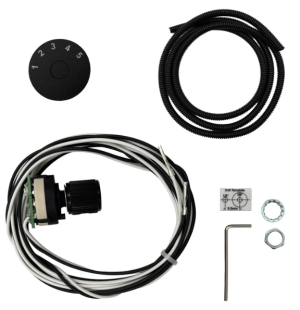

It is absolutely critical to choose the switch designed for your truck's model year, as the ECM wiring and underlying technology are different. Here is a direct comparison of the two TruckTok kits:| Feature | For 2006-2010 LBZ/LMM Models | For 2011-2016 LML Models |
| Core Product | TruckTok 2006-2010 Duramax 5-Position Switch | TruckTok 2011-2016 Duramax 5-Position Switch |
| Compatible Engines | 6.6L LBZ (2006-2007), LMM (2007.5-2010) | 6.6L LML (2011-2016) |
| Key Installation Info | White wire → ECM Pin #46 / Black wire → ECM Pin #54 | Yellow wire → ECM Pin #11 / Black wire → ECM Pin #35 |
| Common Construction | Both feature an aluminum control knob, heat-resistant braided wiring, and are designed for durability in engine-bay temperatures. | |
| The Critical Difference | True DSP5 System: The ECM can store and switch between five different tune files for genuine performance changes. | "Sensor Fooling" System: Due to a locked ECM, it typically works by modifying signals (like fuel temp) to limit a single, high-power tune. |

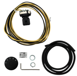

Understanding The 2011+ "Myth": A Vital Distinction
For owners of 2011-2016 LML trucks, this is the most important concept to grasp. Starting in 2011, General Motors changed the ECM architecture, making it impossible to install the traditional custom DSP5 operating system. Therefore, any switch you install on an LML does not function in the same way as it does on an LBZ or LMM.
As outlined by industry experts, the switch on an LML usually acts as an "electronic throttle limiter". You have one high-performance base tune. The switch settings don't load new files; they apply different levels of restriction to that single tune, often by manipulating sensor data. This can lead to unpredictable drivability and, crucially, confuses the transmission, as it's receiving inconsistent torque signals from the ECM, potentially leading to erratic shifting and accelerated wear.

- Disconnect the Batteries: Always start here. Disconnect both the negative and positive terminals.
- Choose and Prep Switch Location: Pick a clean, accessible spot on your dash or center console. Drill the required hole and test-fit the switch.
- Route the Wiring: Run the switch's wiring harness through the firewall and neatly along the factory loom towards the ECM, which is located on the driver's side of the engine bay.
- Access the ECM Connectors: Carefully unclip and remove the ECM weather cover. Identify the correct connector (for the LBZ/LMM, it's often the gray one at the bottom). You may need to depin the specific cavity for the wire.
- Connect the Wires (THE MOST IMPORTANT STEP):
- For LBZ/LMM: Insert the white wire into Pin #46 and the black wire into Pin #54 of the specified ECM connector.
- For LML: Insert the yellow wire into Pin #11 and the black wire into Pin #35.
- Pro Tip: Double-check that the target pin cavities are empty. Forum users have occasionally found mystery wires in these slots from prior work. If a pin is occupied, do not "double up." You must identify the existing wire's purpose or choose a verified alternate pin based on an up-to-date wiring diagram.
- Secure and Reassemble: Secure all wiring with zip-ties, reattach the ECM cover, and reconnect both batteries.
