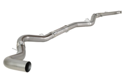

A quality delete pipe removes the entire DPF/DOC assembly and replaces it with a straight-through, mandrel-bent section of tubing. It bolts directly to the factory downpipe and connects to the existing exhaust after the DPF section .

This is the most common entry point. You remove the DPF canister, install a straight replacement pipe, and keep the rest of the factory exhaust intact. Benefits:
Replaces everything from the turbo outlet back—downpipe, DPF delete section, and muffler/tailpipe. Benefits:
If your LMM is a daily driver and you don’t need maximum sound or peak horsepower, a DPF delete pipe with the stock muffler retained is the most civilized setup. It eliminates regen fuel washing, improves response, and keeps cab drone to a minimum. If you’re building a performance truck or simply want the classic diesel sound, a full 4-inch turbo-back system is the path.

Part 5: The Hardware Decision – Straight Pipe vs. Full Exhaust
DPF delete pipe only:This is the most common entry point. You remove the DPF canister, install a straight replacement pipe, and keep the rest of the factory exhaust intact. Benefits:
- Lowest cost
- Easiest to swap back to stock if needed
- Maintains factory sound levels (muffler remains)
- Maximum flow and power potential
- Deeper, more aggressive exhaust tone
- Weight reduction (factory DPF is heavy)
