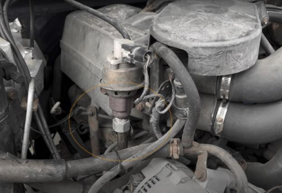

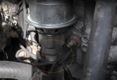

2.Use a wrench to disconnect the pipe connecting the bottom of EGR.

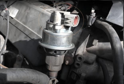

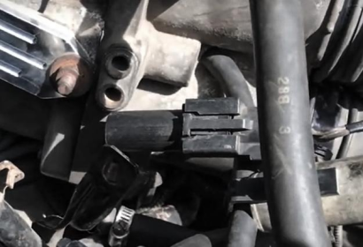

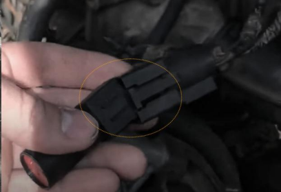

Disconnect the top electrical design of EGR and connect the simulated eliminator provided in the kit to the factory electrical equipment.Insert the EGR eliminator firmly into the wiring harness until the locking plate locks to ensure a good connection. Use electrical tape or zip ties to secure the EGR eliminator and wiring harness to a sturdy object

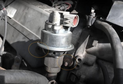

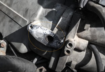

Unscrew the two bolts that secure the EGR valve, remove the EGR valve, and use a scraper to clean the dirt near the hole.

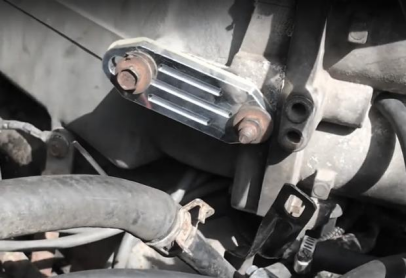

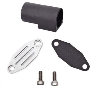

Fix the sealing plate and high-temperature washer in the original EGR position using the two bolts provided in the kit.
