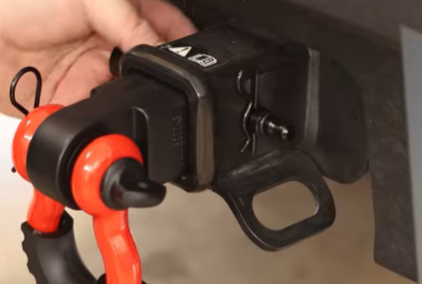

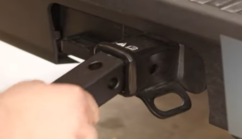

Insert the tail of the trailer hitch into the 2in trailer hitch receiver tube at the rear of the vehicle.

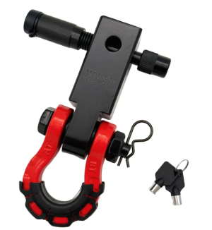

1.To unlock the trailer hitch lock:Align the key with the keyhole, insert it, and rotate clockwise.The lock core will automatically pop out.

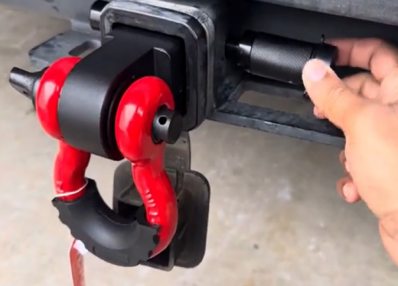

2.Adjust to the desired exposed length and align with one of the lock holes, then insert the locking pin.
3.Press the lock core until it is flush and cover it with the protective cover.

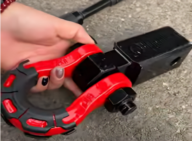

1.Insert the part with the bolt into the top mounting hole of the rotatable trailer hitch.(Rubber gaskets are provided and can be added to achieve a more stable effect.)
2.Install the bolts on the other side for fixation
3.Finally, insert the R-shaped clamp vertically into the hole on the bolt for fixation.
4.If it is a fan-shaped knob, simply rotate it for installation and then tighten it.
