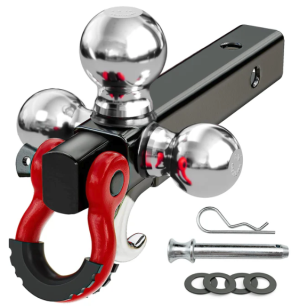

This is the installation process for the TH-0003: 2" Receiver Heavy Duty Tri-Ball Trailer Hitch Mount with Swivel Shackle Tow Hook 1-7/8"/2"/2-5/16" Balls w/Lock Pin, for your reference during the installation process.

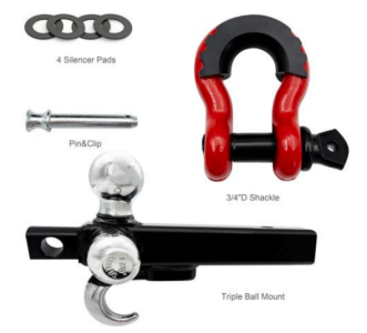

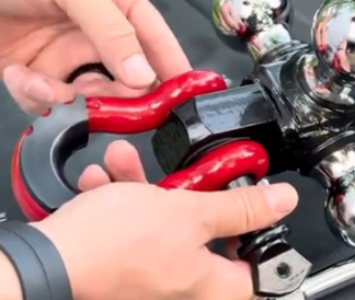

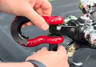

Assemble the D-Ring Shackle (Pre-Installation) Before inserting the hitch into the vehicle, align the 3/4" D-ring shackle with the top swivel mount. Insert the shackle pin through the washers and the mount.

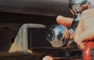

Insert the Hitch Mount into Receiver Now, slide the shank of the fully assembled tri-ball hitch into your vehicle’s 2-inch receiver

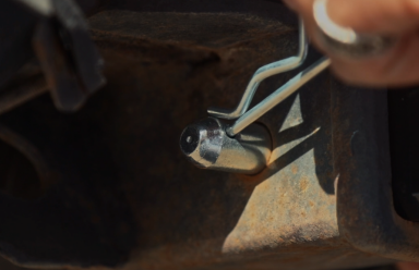

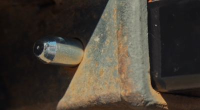

Secure with Silver Pin & R-Clip Insert the Silver Hitch Pin through the aligned holes. On the other side, push the R-Clip (Safety Pin) through the hole at the end of the silver pin until it is fully seated to prevent the pin from sliding out.

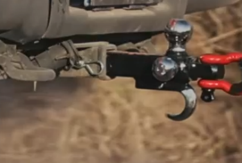

Final Selection & Safety Check Rotate the assembly to choose the correct ball size (1-7/8", 2", or 2-5/16") for your trailer. Double-check that the R-Clip is secure and the shackle rotates freely.
