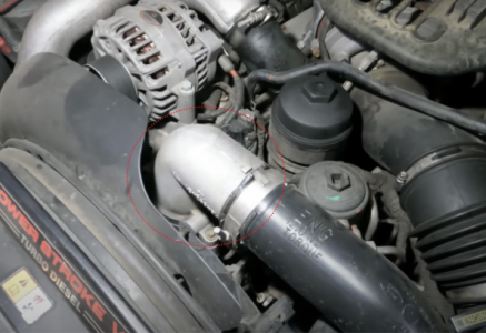

Using an 11mm socket loosen hose clamps and remove silicone coupler from the intake elbow.

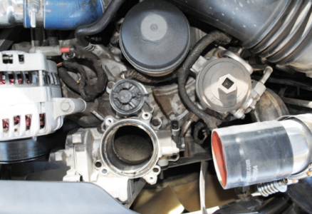

Using an 8mm socket remove the four hex bolts securing the OEM intake elbow in place. (03-04 models may require a 10mm socket for one of the hex bolts).
(For vehicles equipped with a throttle plate) Using an M5 allen head socket remove the three bolts holding the throttle plate in place. Before removing the throttle plate disconnect the two electrical connectors.

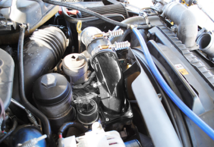

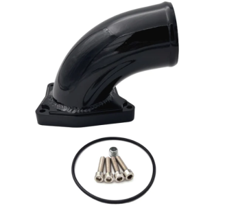

Ensure the O-ring is properly seated in the O-ring groove on the intake elbow ange. Using the supplied hardware and an M5 allen head socket install the Intake Elbow.
Re-install the silicone boot and tighten the hose clamps using an 11mm socket.
