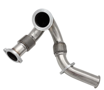

This is the installation process for the DP-0036: 2003-2007 6.0L Ford F250 F350 F450 Powerstroke Diesel Heavy Duty Polished Exhaust Up-Pipe Y-Pipe, for your reference during the installation process.

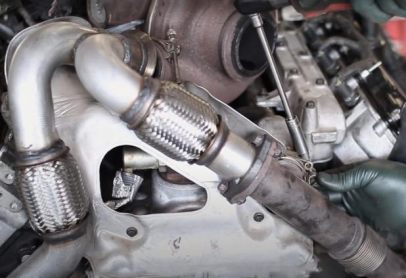

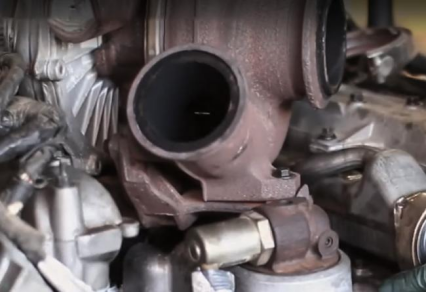

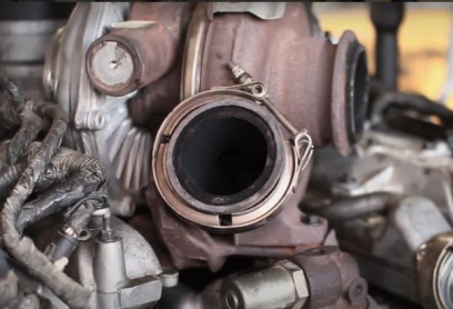

Disconnect the V-clamp connecting the Y-pipe to the turbocharger and remove the inventory Y-pipe.We suggest loosening the three bolts that secure the turbine to the turbine base

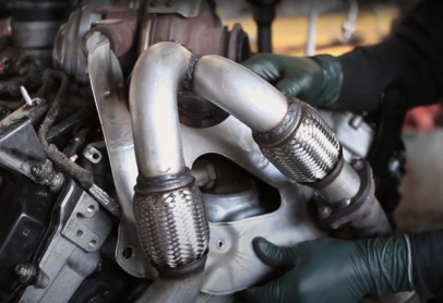

Loosely install the Y-pipe onto the turbine using the factory V-clamp and two M8 bolts on the exhaust manifold.
1.Reconnect the Y-pipe upper pipe with the inventory upper pipe using factory bolts and tighten the screws with a wrench.
2.Tighten the bolts from the Y-pipe to the exhaust manifold in small increments, and alternate tightening of the bolts helps maintain good confidentiality.
