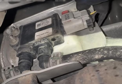

1.Remove all sensors and DEF injector connections from the downspout, SCR, and diesel particulate filter.

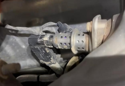

2.Unscrew the bolts at the flange connection of the drain pipe/DPF and SCR/DPF, and loosen,the clamp at the end of the exhaust pipe. Remove DPF and SCR from the vehicle.

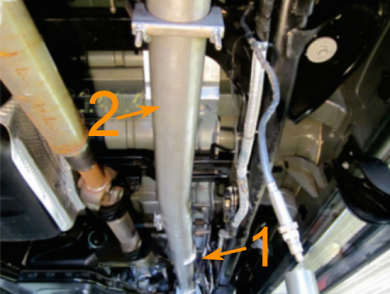

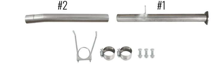

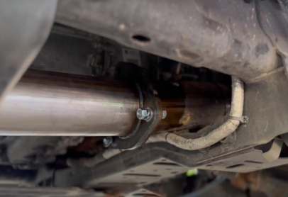

Next, install pipe #2 onto the end of pipe #1 and enter the inlet of the exhaust pipe assembly. Ensure that fixtures are placed at the connection before installing the pipeline. The inner bend should face the truck frame.

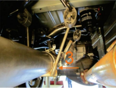

Install #3 fixtures/hangers at the same position on the double hangers of the SCR mounting bracket.

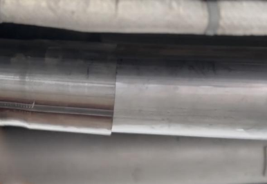

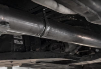

The pipeline installation should be moderately tight, and the new exhaust system should be adjusted to meet the clearance and appearance requirements.Tighten all connections and fixtures evenly, starting from the front flange connection and then proceeding with the subsequent connections.

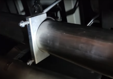

Loosely tighten the flange to the flange end of the downspout and insert the metal, install the #1 pipe, and insert the hanger into the OEM rubber insulator.Step 3:
