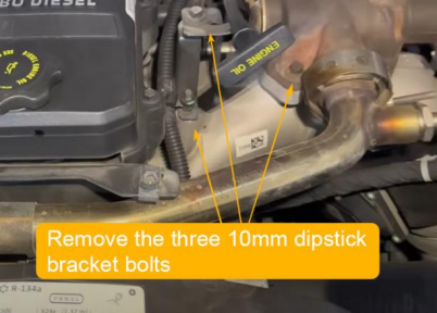

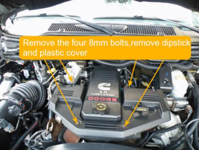

Remove the plastic engine cover that is held in place by four 8mm bolts.
* The dipstick must be removed in order to remove the plastic engine cover.

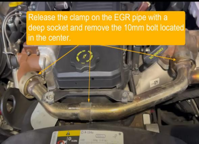

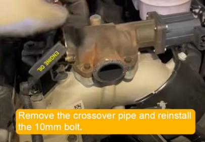

1.Loosen the two V-clamps using an 11mm socket. Remove the 10mm bolt from the center of the tube and disconnect the sensor plug. The EGR crossover pipe can now be removed.

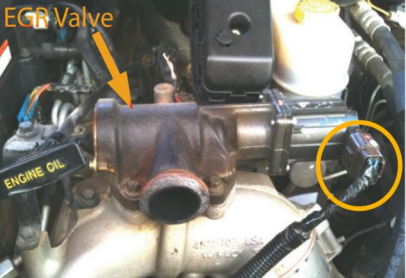

2.Remove the electrical connector on the EGR valve.

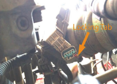

3.Some electrical connectors may have a locking plate. In order to disassemble these connectors, the locking plate must be slid to the "unlock" position.

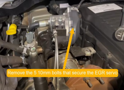

2.Remove the five 10mm bolts securing the EGR servo mounting bracket in place.
1.Simultaneously remove the EGR servo (still attached to the mounting bracket) and the exhaust bypass from the vehicle.

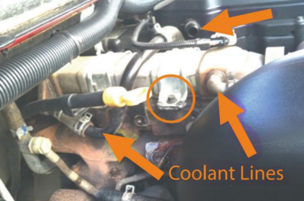

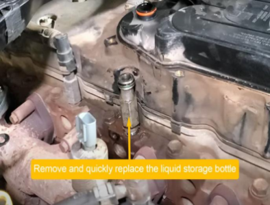

2.Remove the crankcase breather tube that runs over the EGR cooler. Also, disconnect the two coolant lines running to the EGR cooler. Be sure to remove the O-ring from the tting on the engine block.

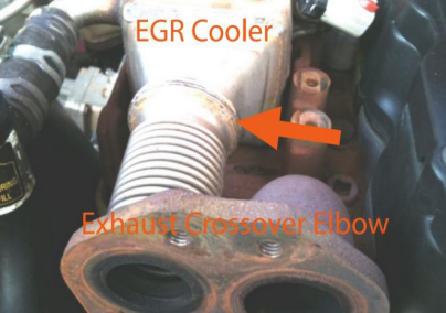

4.Remove the two 15mm nuts connecting the EGR cooler to the exhaust manifold near the rewall.
5.Remove the V-band clamp that is connecting the EGR cooler and the exhaust crossover elbow.

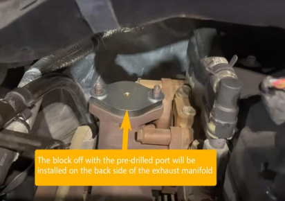

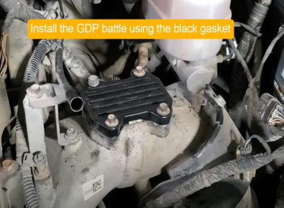

1.Install the other exhaust block off plate, reusing the factory hardware.The block off with the pre-drilled port will be installed on the back side of the exhaust manifold.

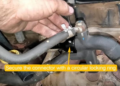

1.Insert the provided black coolant adapter into the pipe and secure it with a locking ring.
2.Secure the connector with a circular locking ring.

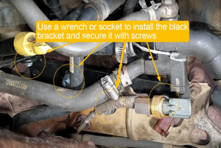

1.Use a wrench to install and secure the long nut.
2.Fix both ends of the hose at the interface.
3.Use a wrench or socket to install the black bracket and secure it with screws.

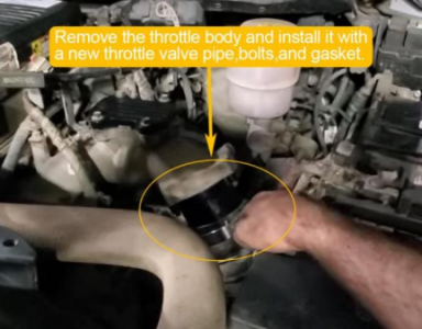

The throttle valve is located on the driver's side, directly below the intake elbow.Remove the throttle body and install new throttle pipes, bolts, and washers.It is
Important to unplug the plug to prevent the throttle valve from permanentlyclosing.

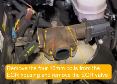

4.Remove the EGR valve that is held in place by four 10mm bolts.

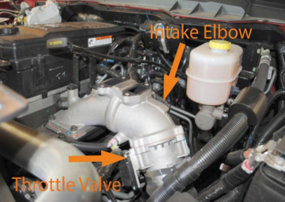

2.Pull off the electrical connector on the back of the throttle valve (equipped with a locking plate). The throttle valve is located on the driver's side, directly below the intake elbow. To prevent the throttle valve from permanently closing, it must be removed.

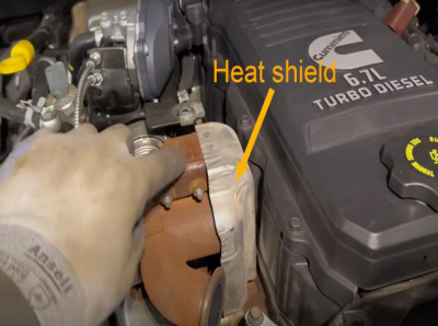

3.Remove the heat shield from the EGR bypass valve. The insulation board is fixed in place by three 10mm nuts and two 8mm bolts.

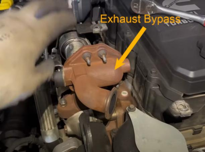

1.Remove the four 10mm bolts that secure the exhaust bypass in place with the heat shield removed. The exhaust bypass will be removed together with EGR servo.

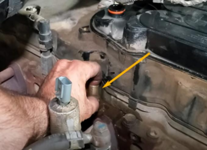

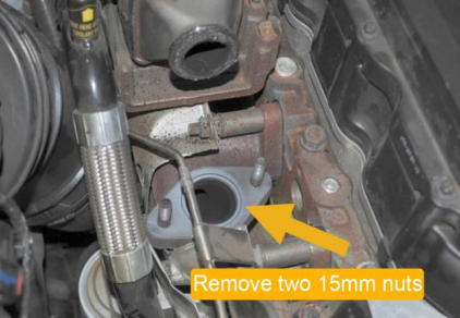

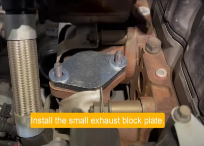

Remove the exhaust cross bend fixed in place by two 15mm nuts. Install the small exhaust block plate.(*The block o that is not pre-drilled will be installed in place of the exhaust crossover elbow.)

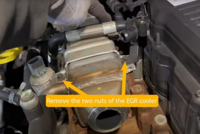

2.Remove the four nuts of the EGR cooler.

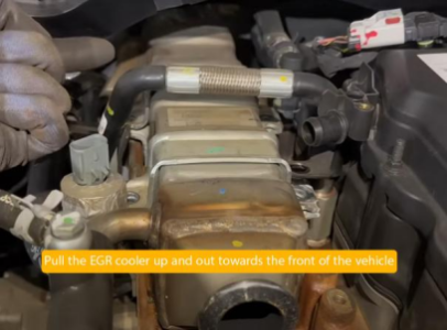

3.Remove the EGR cooler, this can be done by pulling the cooler up and out towards the front of the vehicle.

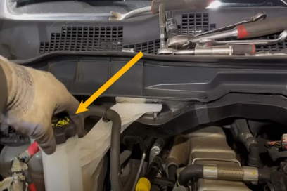

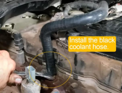

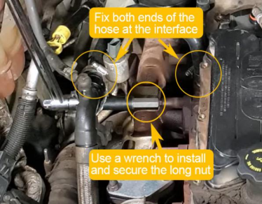

Use a wrench to remove the reservoir and quickly replace the brass fittings in the kit to prevent further coolant leakage.
