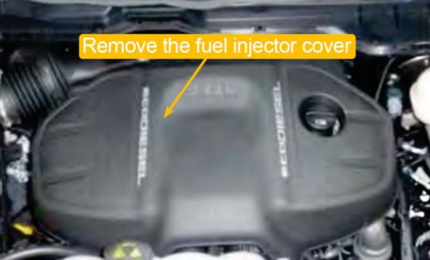

Step1:
1.Remove the injector cover by firmly pulling on each side of the cover to dislodge the locating pins and free the cover from the engine.
2.Remove the sound absorbing foam pad under the fuel injection cover to expose the EGR pipe (in the white heat insulation film).

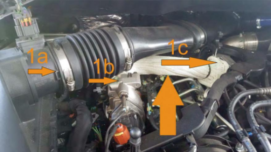

1.Loosen the clamp on the flexible rubber hose on the air intake tube at the filter side. See 1a Once the clamp is loose,
2.pull the hose out and away from the filter box. Lift up carefully along the intake tube until you release the ball and socket style joint holding the intake tube in place.
3.With this joint loose you will have enough room to lift the intake tube up enough to easily access the bolts on the EGR tube.
1.using a socket, remove the two 10mm bolts holding the EGR tube on the cooler side. See 1b. A Keep these bolts!
2.Using a socket, remove the two 8mm bolts holding the EGR tube on the intake manifoldside. See 1c.
3.With all 4 bolts removed lift up on the EGR tube from the cooler side until it clears and then slide the EGR tube to the passenger side to remove it from the intake manifold.

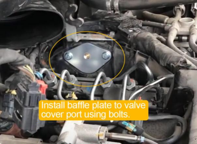

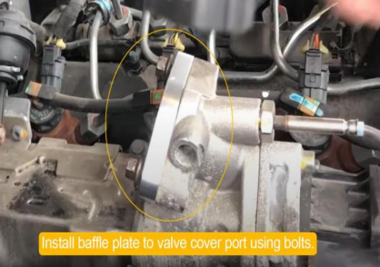

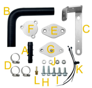

Using the provided 2 x 10mm bolts, Part #H install blocker plate Part #G onto the valve cover port.
Note:The intake side blocker plate comes with a port for mounting an optional boost gauge. If using an additional boost gauge install Part #L If no boost gauge is desired then leave plug in place. If you are doing a phase 2 install then skip ahead to step 11. If you are doing a phase 1 install only then continue with steps 8-10 only.

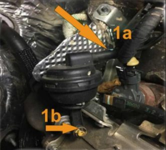

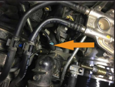

1.Disconnect the vacuum line from the EGR actuator. See 1a.
2.Follow the vacuum line from the EGR actuator to the solenoid, removing any clips you find along the way. The solenoid is located on the passenger side of the throttle plate assembly.
3.Remove the Vacuum line from the solenoid.
4.Carefully guide the vacuum line out towards the front of the truck to remove it completely.
1.Remove the E-Clip and washer from the EGR actuator. See 1b on Step11.
2.After removing the 2 T-25 bolts from the bracket, pull the actuator off towards the front of the vehicle.

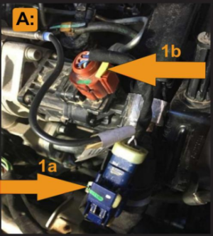

Removing electrical componants.
1.Disconnect the blue connector.See 1a in A
2.Disconnect the red connector.See 1b in A.
3.Disconnect the large black connector by carefully pulling the red tabs and then lifting the grey handle separating the plug. See 1a in B.
4.With the plug loose, push the fixed part of the plug towards the ground exposing the 2 clips that hold the plug onto the bracket. Remove the plug and any other clips from the bracket.

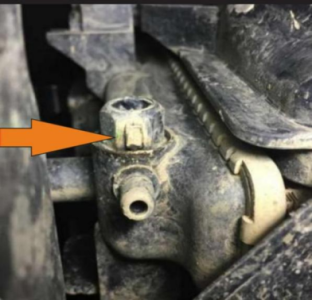

1.Open your coolant reservoir cap and then locate the radiator drain plug under the front drivers side. You can use a 16mm wrench to open the drain but be very careful not to break the plastic plug itself.
2.Drain about 1 gallon of coolant or until it begins to drip slowly. Re-tighten and secure the plug.

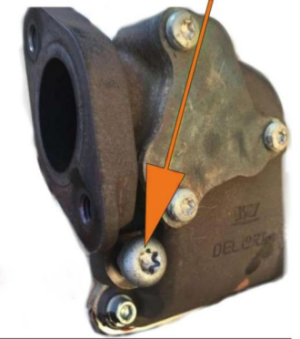

1.Locate the EGR up pipe directly behind the EGR actuator removed in step # 9, and remove the 2 10mm bolts that connect the tube to the EGR unit.
Locate and remove the T-40 Torx bolt just under the flange bolts you took out of the
2.EGR up pipe in the previous step. Note: This bolt can be tough to get.

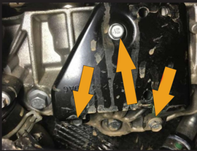

3.Locate and remove the 3 13mm bolts from the black, lower Support bracket.

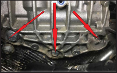

Remove the 3 13mm bolts holding the lower EGR cooler manifold in place. The right and left bolts will be reused to bolt on bracket part #C later.

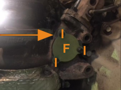

Using the supplied bolts part #I,and the factory gasket,install the turbo manifold plate part #F.
Step 17:

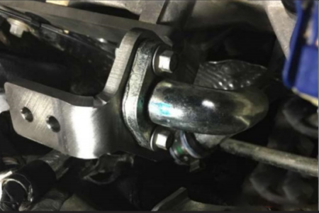

Using 2 13 mm bolts from the turbo manifold in step #13, mount the supplied blocker/mounting plate part #C using the same holes the bolts came out of.

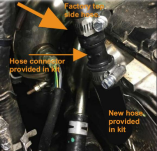

Go back to where you removed the lower coolant line in step #11 from the hard line and using one of the provided hose clamps, fasten the supplied hose, part #B to the hard line.
Step 20:

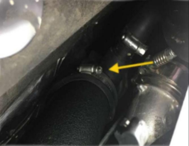

1.Now locate the upper coolant line and put one of the supplied hose clamps on the end. Then using part #A, connect the upper and lower lines and secure clamps.
2.Secure the coolant hose to the new bracket from step #18 with provided zip tie.

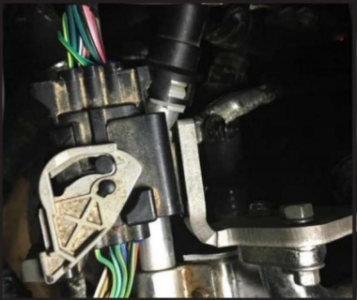

Reattach the large electrical connector to the new bracket. Tie any left over wiring to the bracket to ensure it cannot be damaged.
