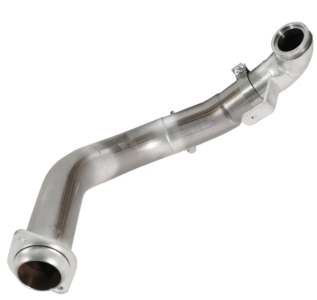

This is the installation process for the DP-0316: 2020-2024 6.7L Ford powerstroke 4" downpipe Exhaust, provided for your reference during installation.

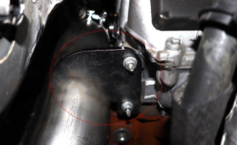

Finally, remove the two nuts and two studs securing the lower section of the exhaust downpipe to the passenger-side cylinder head. After removing them, pry and shake the exhaust downpipe until it detaches from the upper section. It may be necessary to remove two exhaust downpipe hangers to move the exhaust downpipe and create sufficient working space at the bottom.

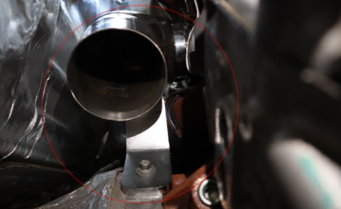

Now you can begin disassembling the upper part. First, loosen the 11mm nut on the T-bolt clamp, then remove the lower exhaust downpipe clamp that connects the upper part and the rear of the turbine.
After removing the exhaust downpipe clamp, you can remove the 10mm bolts that secure the upper exhaust downpipe to the engine cover. Then, begin installing the 4-inch stainless steel exhaust downpipe.

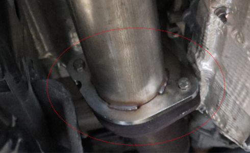

Next, install the lower assembly. Install the clamps that came with your package onto the exhaust downpipe, making sure the nuts are facing the firewall. Slide the lower assembly into place and install it onto the upper assembly. Reinstall the two studs and two nuts to secure it in place.
After tightening the nuts and studs, the clamps that secure and seal the lower component to the upper component can be tightened.
After securely connecting the two exhaust pipe sections, reconnect the exhaust system to the exhaust downpipe. Check for leaks; if there are no issues, reinstall the mudguard liner.
