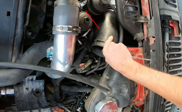

Remove clips for plastic wire way located above turbo. Fold to windshield of truck.

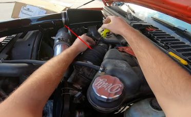

Remove upper fan shroud by prying away from radiator through slots.

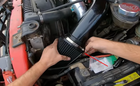

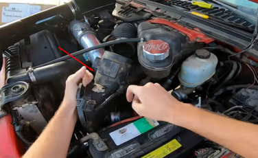

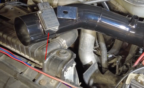

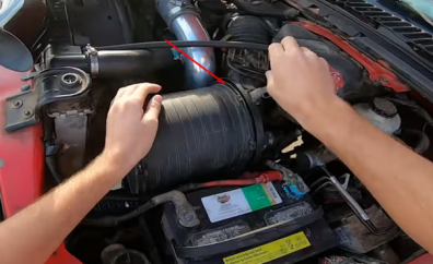

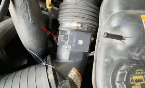

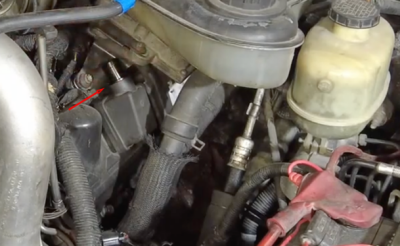

Loosen hose clamps and remove intake tube. Then unscrew bolts and remove turbo inlet tube and PCV Valve.

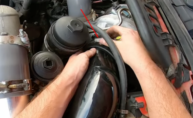

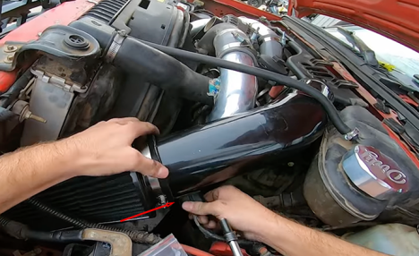

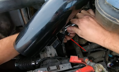

Loosen clamps and remove charge pipe.Unbolt alternator and disconnect wires. then tilt towards front of vehicle. Note: it is not necessary to loosen belt tensioner.

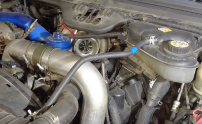

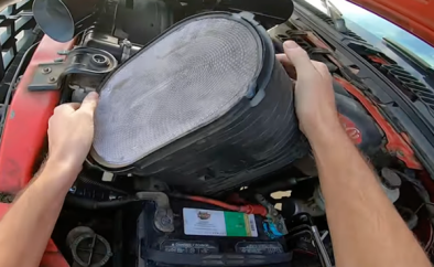

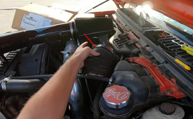

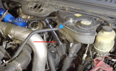

1.Remove turbo charger. This is done by removing the two oil feed line bolts, VGT actuator wire, Up-pipe v-band clamp, and the three turbo mounting bolts. It is strongly recommended to use penetrating oil on all turbo bolts, exhaust up pipe bolts, and pedestal bolts. Once these parts are removed the turbo will roll toward the passenger side of the truck and out of the pedestal.
